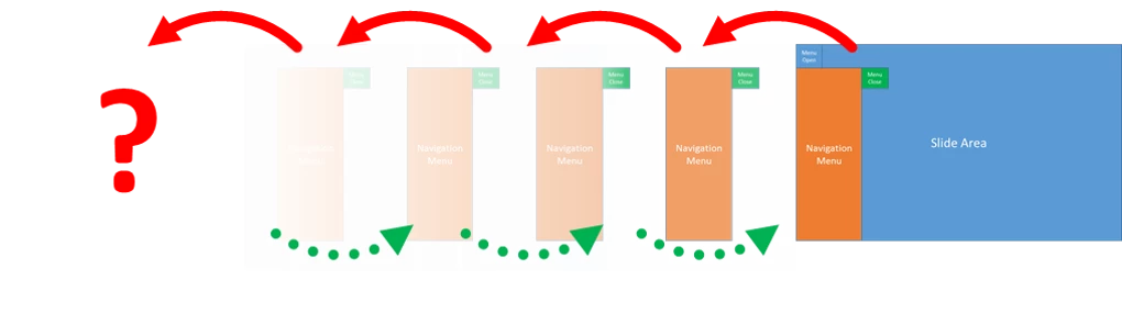

So, what is going on here?  What I think is happening is that the apply effect is not operating from a relative position, and is instead shifting a little to the left each time the open/close sequence runs, like so:
How can I stop this from happening?  If you move 500 pixels to the right with a push of a button, and then move back 500 pixels, logically, you should always end up in the same place, no matter how many times the menu is opened/closed.  What is going on?
