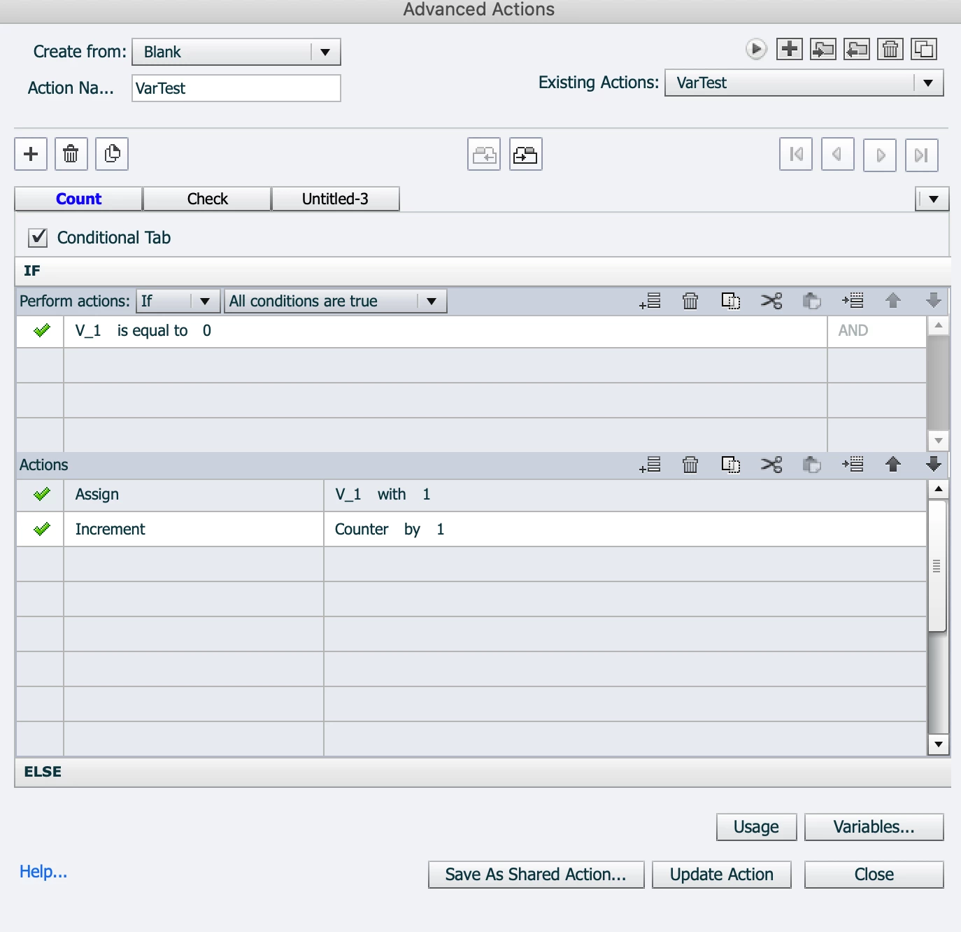

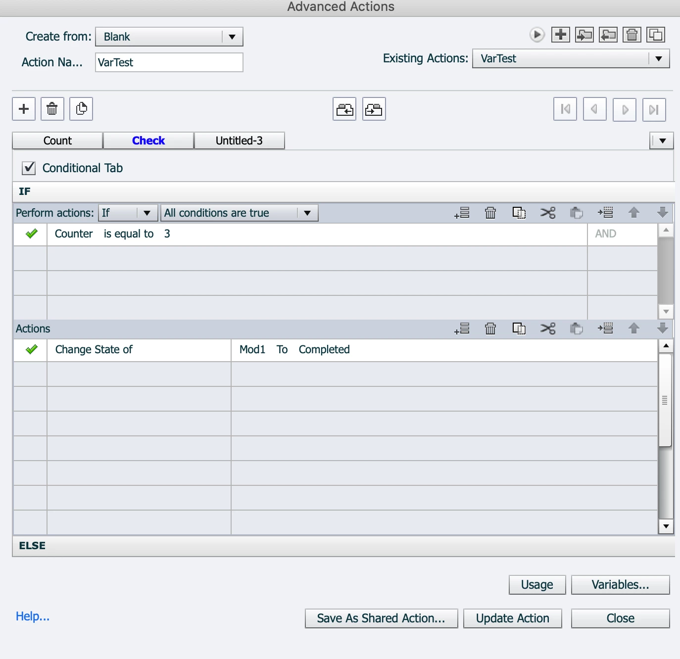

    Since you have already a user variable for each slide, you should use another type of shared action in which you use a counter variable. Use the On Enter actoin of the slide to  increment the user variable, increment the counter variable only when the slide variable is equal to1. That way you have only the counter variable to check. I use that approach a lot because I prefer shared actions over advanced actions fro several reasons. In one of the demo projects I used during my presentation at the Adobe eLearning World conference  I used that approach. It has been explained more in dettail in a blog (had no time during the presentation);

    Thanks for getting back to me. I am unsure about the shared actions but I have changed my existing AA based on your advise which already makes this a lot quicker to set up than before.
    I would still like to work out a way to automate this a bit more, so will explore what I can do with shared actions. I'm not getting it at the moment, so will revisit again soon.
