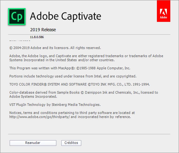

Hi, Lilybiri
  • which exact version you are using: Adobe Captivate 2019 - 11.8.0.586 (attached image)

Lilybiri
Apr 11, 2024 3:59 PM UTC
I now understand your translation, because you are using the Spanish version, where 'Play Audio' command is translated to 'reproducir audio' which seemed strange to me, but my  Spanish is rusty, didn't use it actively since years.
This is a action triggered by the Success event of the image used as button.  I thought all audio was loaded when the slide was entered, as Rod explains but that seems not to be the case. You tested from the same system where you created the project? If yes, is it possible to test from another system on SCORM Cloud? Did your testers use the same browser?
I cannot double-check because I don't have that (buggy...) version on any system. I have the 11.8.2 version (also buggy).
