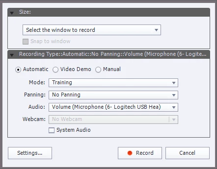

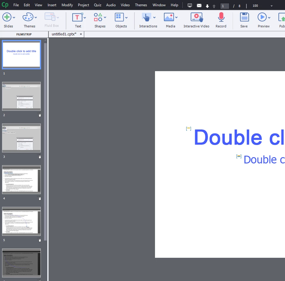

    Captivate allows for different types of recording.
    I usually choose 'Automatic  >   Mode: Training' so when the recoring is done, it appears as slides in Captivate.
    I delete the slides where I went wrong, the mouse cursor automatically compensates for deleted slides
    I change the styles of the captions to automatically format them all and edit their content
