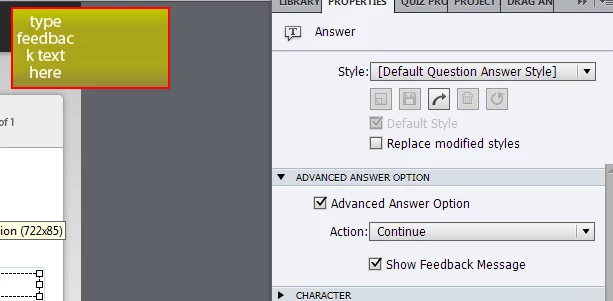

Sreekanth meant that Advanced Answers are only available for one type of question MCQ (Multiple Choice), and only when 1 correct answer is possible.
I would offer a tip when working with Quizzes: please change the workspace to Quizzing, so that you have the Quiz Properties in the left dock and the Properties in the right dock, because you'll have to use both intensively especially when working with Advanced Answers (not Actions, Sreekanth). You have to select an individual answer to see the Advanced Answer Option appearing. Don't confuse with the Action accordion that is on Question Slide  level, not on Answer level.

October 9, 2013
You can do that for single answer choice type of questions.
Double-click the option, select the Advanced Answer check box and Show Feedback Message check box from the Advanced Actions accordion of Properties. You will now get a new text box where you can add the feedback for that option.
See the screenshot for reference.
