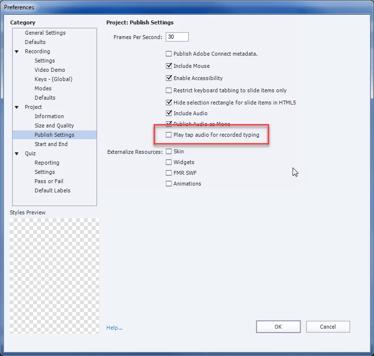

Feb 26, 2018 8:49 PM UTC
When you publish your project, there will be no tapping sounds if you deselect the option in preferences for Publish Settings:
