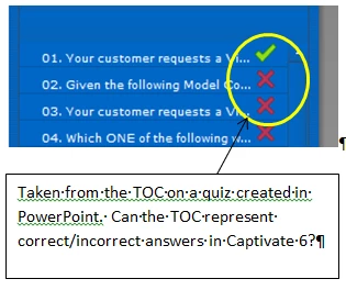

Is it possible to generate an indication within the navigation Table of Contents to display to the user a visual indication of correct/incorrect while the subject is taking the quiz?
Any help in this endeavour is greatly appreciated! I've looked everywhere and can't solve this one.

OK. So I told that the editing possibilities of the TOC are limited. You can create a slide that will show this after the quiz. I suppose you do not only have question slides, and the score slide is not sufficient for you.
This will necessitate the use of variables and advanced actions. Do you know anything about those features in Captivate?
