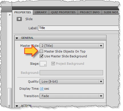

Any element native to a quiz question slide (e.g. Question Title and Question Text or Answer captions, navigation and submit buttons) will always appear on top of any objects you add to it as part of your interaction.
If you need something to look like it is on a higher level, you might be able to achieve this using Master Slides.  Just tick the option to have Master Slide Objects On Top.

I'm actually having the opposite problem to what you are sugegsting a solution to. I'm not using a default Captivate quiz slide, but rather a quiz slide generated by inserting a question widget. In this scenario, the widget is a native element to the quiz slide (i.e. it does not appear on the timeline) but it displays behind rather than in front of objects such as text boxes which I add to my interaction.
That said, your Master slide idea will still work, I just need to make sure I keep Master Slide Objects On Top unticked! Its not a perfectly clean solution because it means having single use master slides and negates the benefit of having an updatable master slide which updates all slides, but I think the benefits outweigh the cost, and its certainly a better workaround that what I was doing.
