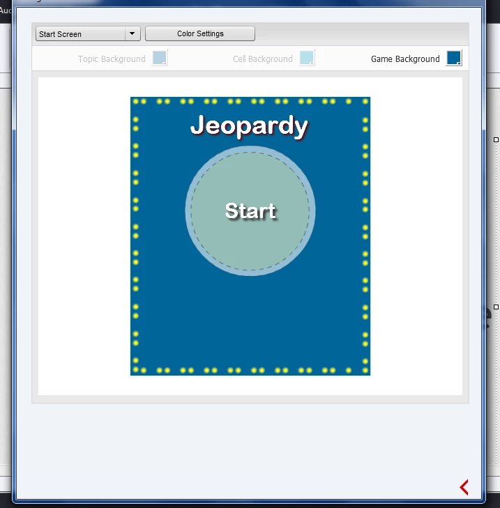

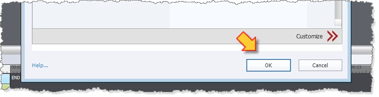

No joy.  Your picture has a grey bar and the two buttons "OK"  and "Cancel".  Your picture also has "Help" on the left side.
Mine still has nothing at the bottom, no help file, grey bar, nor buttons.  You can see the picture below.  Any other ideas?   The help desk opens at 6 pm PST and I'm counting the hours.

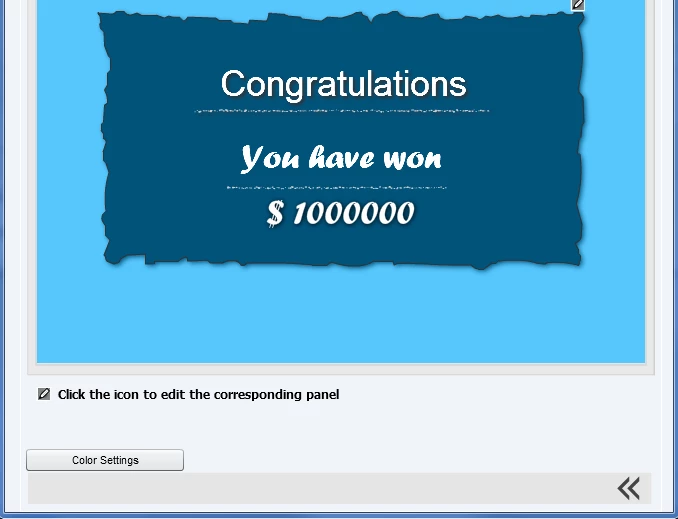

I thought to try "Who Wants To Be A Millionaire" learning interaction as well.
It has the same exact problem as Jeopardy widget with no way to exit out of the program other than starting the Task Manager and force closing.  Both widgets have this problem.

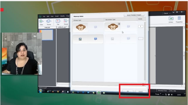

According to Dr. Pooja Jaisingh's screen shot from Ytube there should be an OK and Cancel button (highlighted below) in the program to actually save it into the project.  Sounds like a major bug fix is needed.
