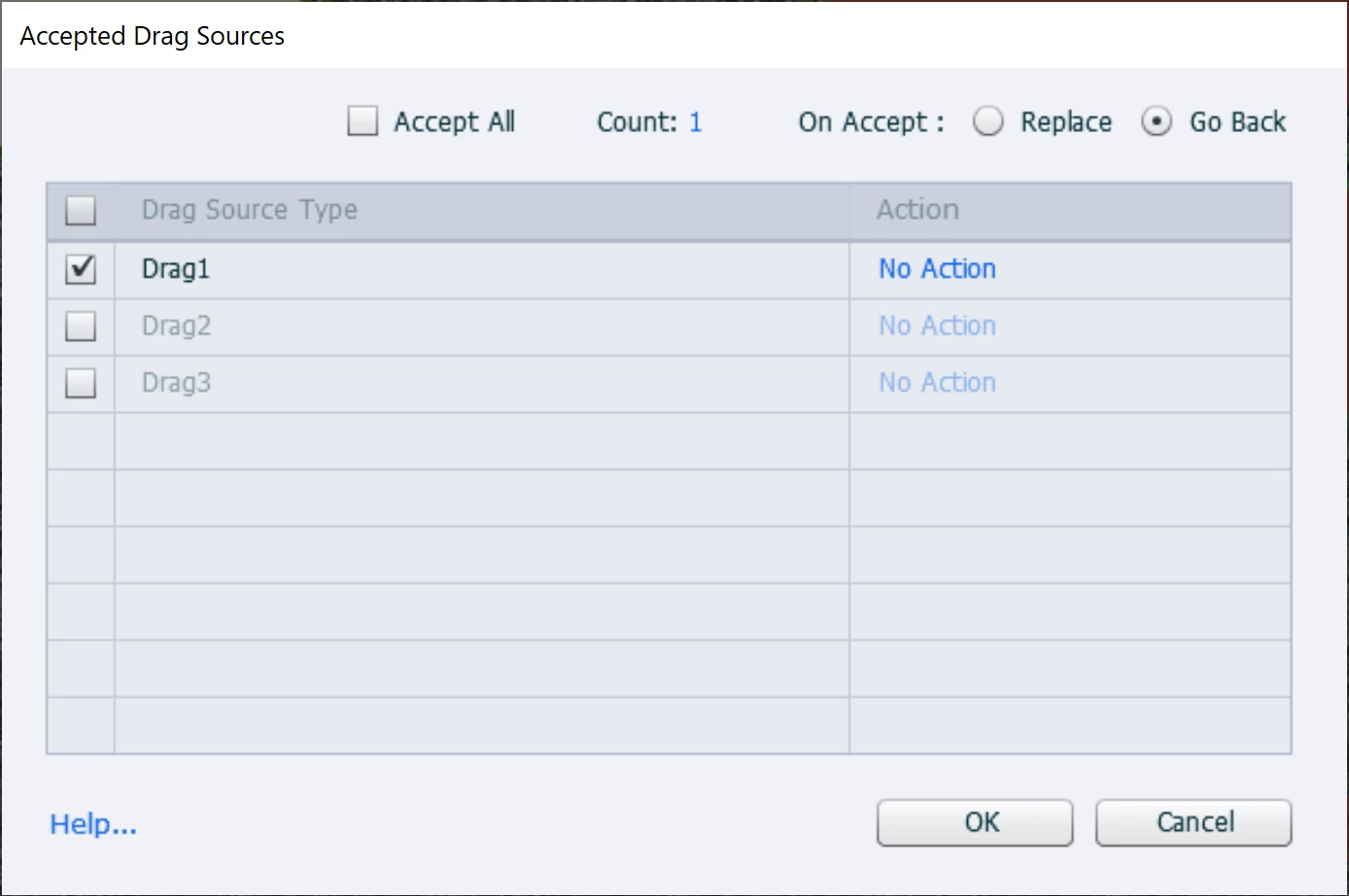

    To have the incorrect drag sources return to place, use the Accepted Drag Sources dialog box (with the button Object Actions which you use for Rod's workflow). Uncheck Accept All, set Count to 1 and check the correct answer. By default Go Back will be activated. Here is an example for a situation with 3 drag sources. It has to be done for each of the drop targets.

    Nov 29, 2020 2:25 AM UTC
    Many thanks, Rod! Tried this and it worked 🙂
