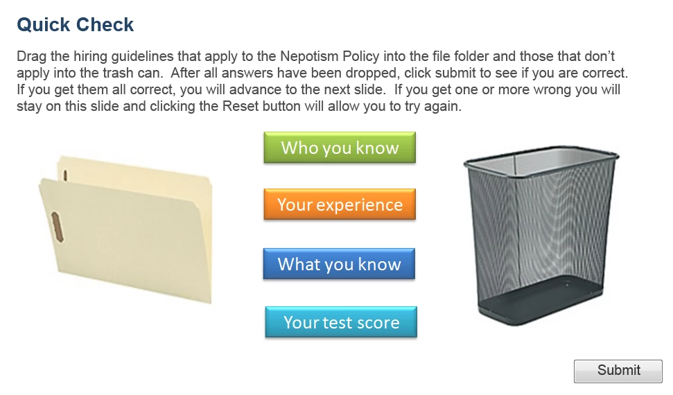

Good Afternoon!
I created a drag and drop in Captivate 8 that has 2 targets and 4 drag sources.  3 of the sources go to 1 target and 1 source to the other.  What I am trying to do is:
1.  When the first source is dropped the next on the list appears and so on for the 4 options.
2.  When the user clicks the submit button a "Congratulations" message appears.
3.  When the wrong answer is dropped, the source snaps back into the list.
I've tried so many different configurations....any help is much appreciated.

Thank you!!  Here is a screen shot of my drag and drop slide.  When the learner first lands on the slide I would like only 1 box to show.  When that box is dropped to a target, the next box will display, etc.  Is there a way to do that or am I being too complicated?

Wanted to double-check, so I created a short project with
  • four text containers as drag sources: S_one, S_two, S_three, S_four
  • two drop targets Target1 and Target2
  • S_one and the two drop targets are visible in output
  • S_two, S_three and S_four are invisible in output
  • in my setup the first three drag sources had to go to Target1, and S_four to Target1; your setup can be different, but you define the sequence of the drag sources, so you know perfectly well which one has to go to which target
  • set up the D&D in the usual way
  • Select Target1, and press 'Object actions' the format tab of D&D panel. Because I am in CP9 which has the possibility to uncheck 'Continue Playing project' for a simple action, I could use those. Look at this screenshot:
    I unchecked Accept All, and indicated the three correct drag sources, changed the Count to 3 because they will have to be accepted all of them on the first target. Wrong drag sources will 'Go Back' to its original position.
    After dragging S_One the action has been changed to Show S_Two (second drag source). You have to change that simple action to a standard action 'Execute Advanced Action' with the same unique command 'Show S_two' to avoid releasing the playhead. I would use a shared action if you are familiar with that. Similar setup for the two other drag sources, just change S_Two to S_Three for the second action, and to S_four for the third action.
  • Select Target2, press Object actions again, uncheck 'Accept All' and indicate the correct drag source, Count is 1 this time. In my setup you don't have to choose the action, because it is the last drag source. However if the drag source is not S_four for this target, you'll have to put in a similar action as I explained for Target1, and take out the action on the last drag source which will then be within the dialog box for Target1.
