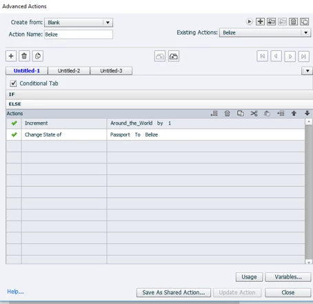

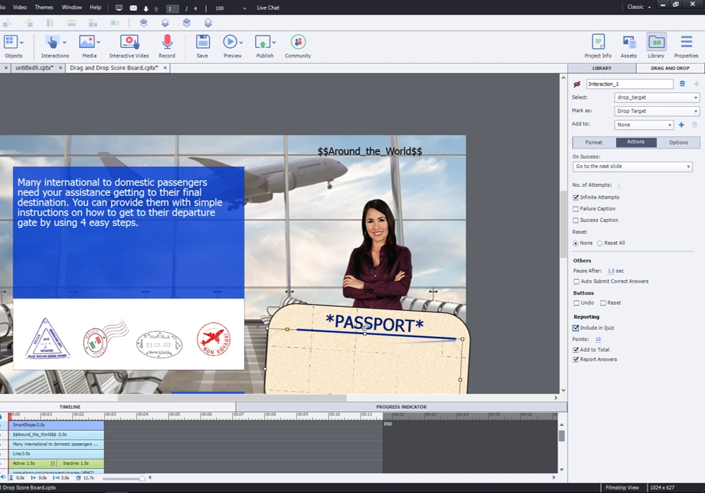

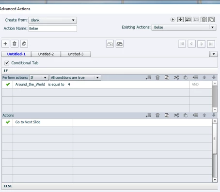

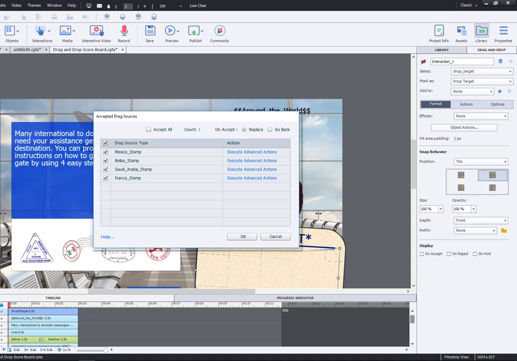

kuhdeAuthor
Jul 25, 2019 6:15 PM UTC
Thanks for the reply.
Here are some screen shots of what I currently have going on:
If I understand your solution correctly I should delete the conditional statement and set my Object Actions for the drop items to execute the advanced action of only changing the state and increment the variable.
(currently the advanced actions on this slide are set to the Advanced Actions shown above with the If statement set to Equal to 4))
Do I create an advanced action that says IF Around_the_World is equal to 4
Then Go to Next Slide? and should this AA be tied to the Passport Drop Target or On Enter for the main slide?
Again, thanks for the feedback.
