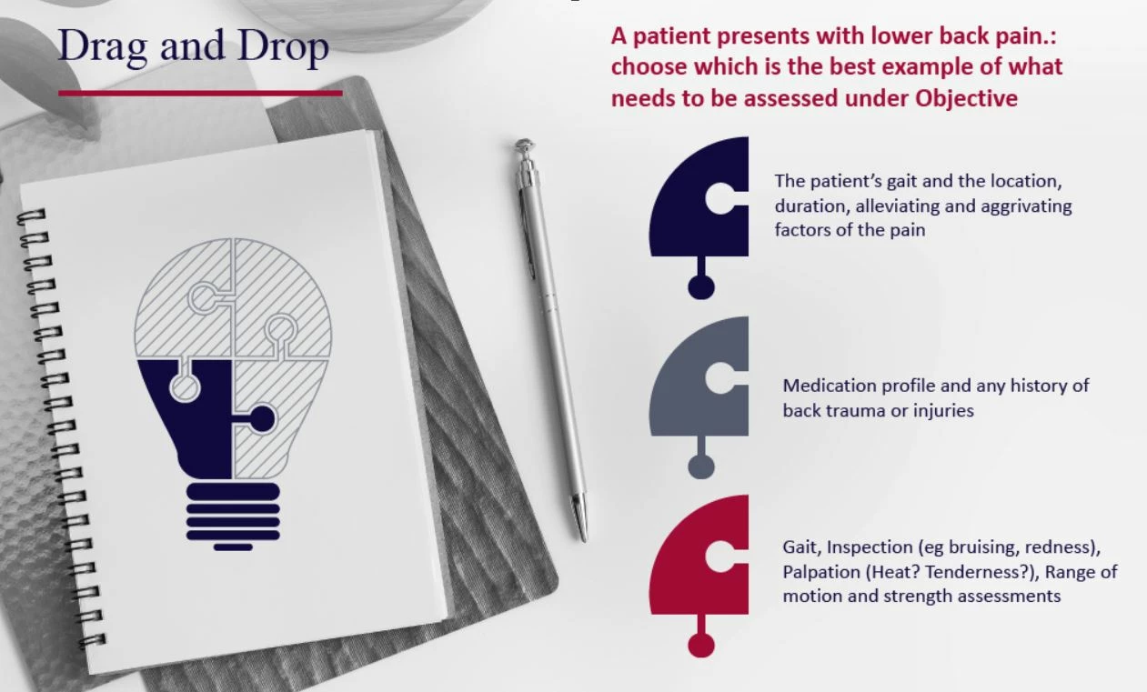

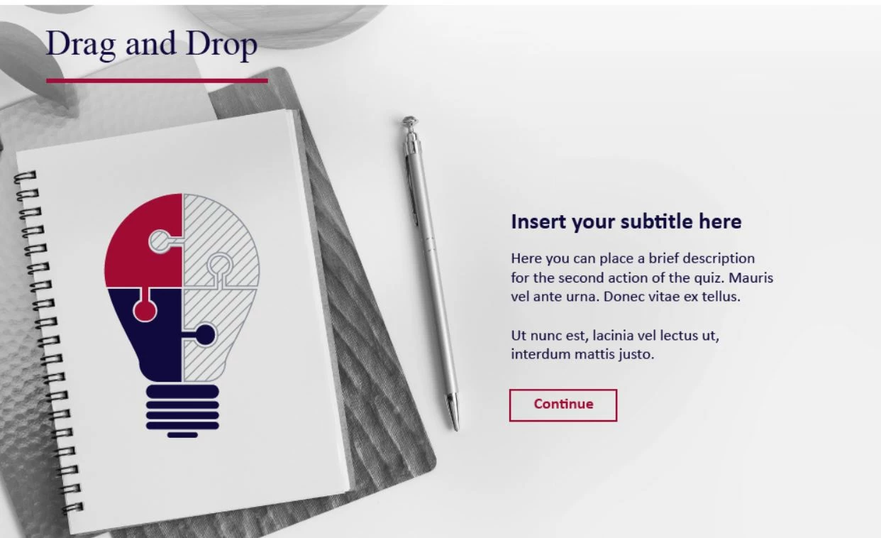

I am using Adobe Captivate 2019. I am using the slide set "Business" - speciafically one of the drag and drop interaction that I added to my course (see picture 1). However when I preview it, and complete the correct drag and drop, there is a second part that appears that I cannot for the life of me find out how to edit (see picture 2). Please help!

    Sighing... without better instructions those slides can be very confusing. What you see after the correct answer is a group of items which are hidden with the On Enter action os the same slide. That group has a label which depends on the D&D slide (there are 4 slides of this type which seem to be meant to be used in sequence, look at the light bulb graphc). For the first slide group label is DD1_out_2.
    Why?  That is not so clear to me,
    Do you just want to get rid of that phenomenon?  Change the Correct action on the D&D panel to 'Go to Next Slide' to replace the Advanced action.
