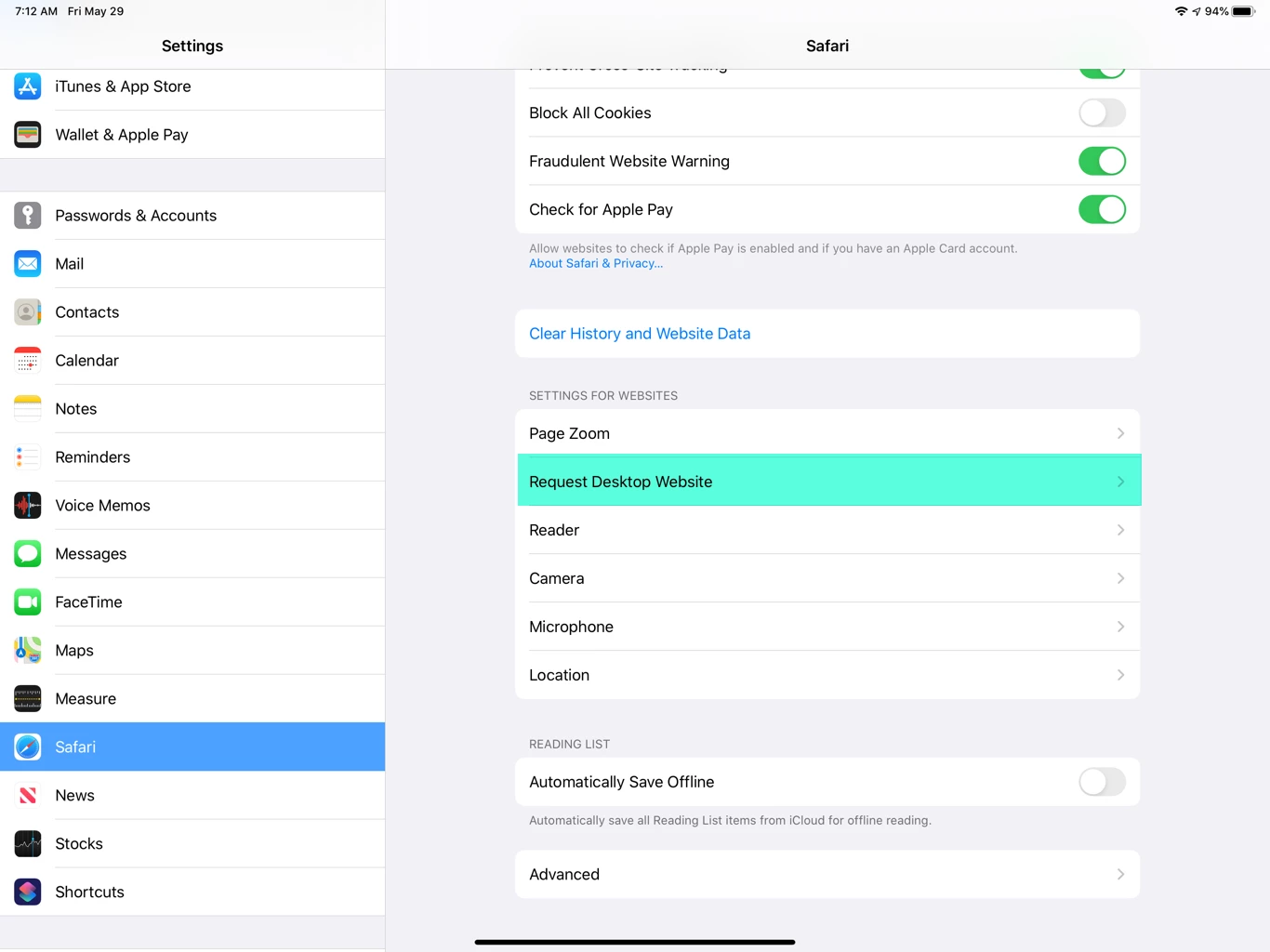

You might want to go into the settings for the Safari App and turn off the setting for request desktop website.
This will allow Safari to use the mobile settings and drag and drop should function.
At least it does for me.
