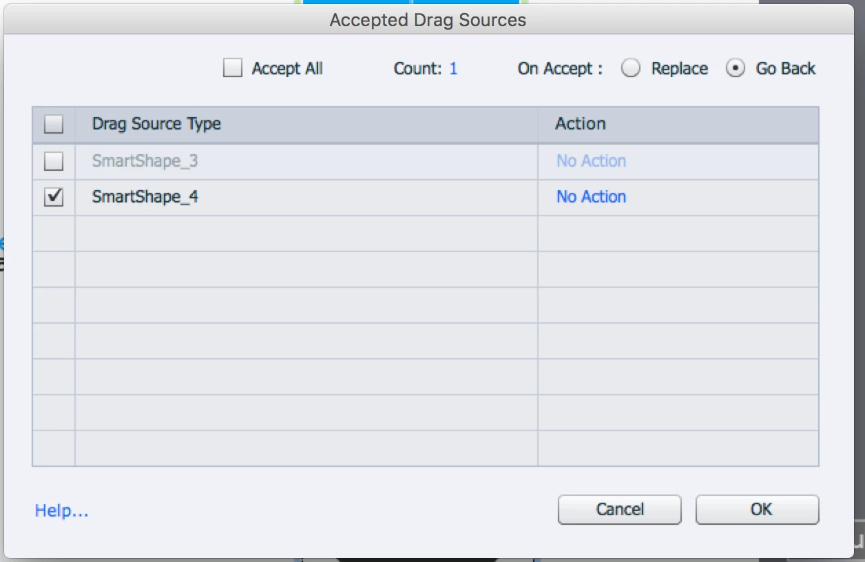

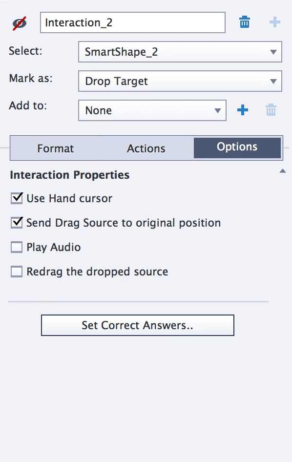

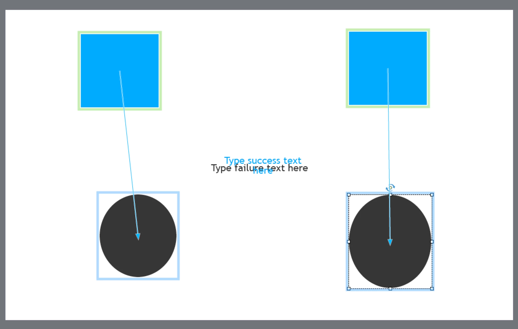

So here what i build: (1) I have a drag and drop slide. 2 sources and 2 targets. (2) Only one of the target is accepted, for each of them. (3) I send the sources back to original position if it is the wrong target. (See the images for clearer understanding.)
(1) (2)
(3)
And here what's going wrong:
Now when i preview it in HTML5 and i drag the source to the wrong target, it snaps back, and if i try to drag it again very quick i can't grab it. But if i wait 1 or 2 seconds it will work! The weird thing is, if i drag it somewhere else (anywhere except the targets) and try to grab it again very quick, i can grab it instant!
