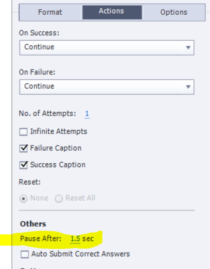

By default a D&D slide gets a pausing point (invisible on the Timeline) at 1.5secs. Can you check that in the Drag&Drop panel undeer the Actions tab, Others:
You cannot take out that pause, but it could be set at a duration which is higher than the slide duration. Seems improbably, but you never know.
How did you test it? If this is a non-responsive project, you need to know that the only valid Preview method is F11, Preview HTML in Browser. How are the two non-functional D&D slides behaving in that Preview?

thank you. I have tested it in our LMS SCORM Cloud and the Preview HTML. does not work. it only works when I hit 'preview project'. changing the pause after has no impact unfortunately
