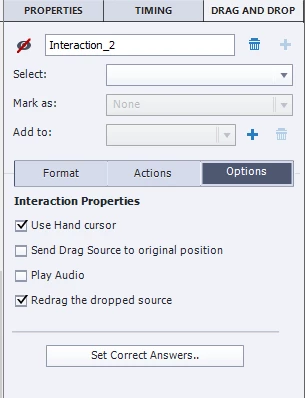

Hi. I have been following the videos to the tee, but after I drag the object and drop it in the new location, it goes back to the original location. I don't know why. Help. 🙂

    Under the Options tab, uncheck the option 'Redrag the dropped sources'. I think that will solve the problem.
    If not, I had a typo (late here) in the list of screenshots. I also wanted the Object Actions for the drop target where you have issues. You need to select the Drop target, the button will appear in the Format tab.

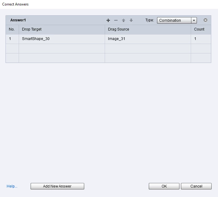

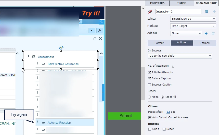

    Can you post some screenshots? The different tabs of the Drag&Drop panel, the dialog box for the Object actions for the drop target which shows this 'return to location', the Correct Answers dialog box.
    February 23, 2023
    I've attached 3 images. I hope this helps. Thanks so much!
