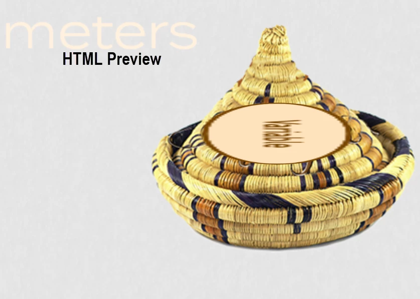

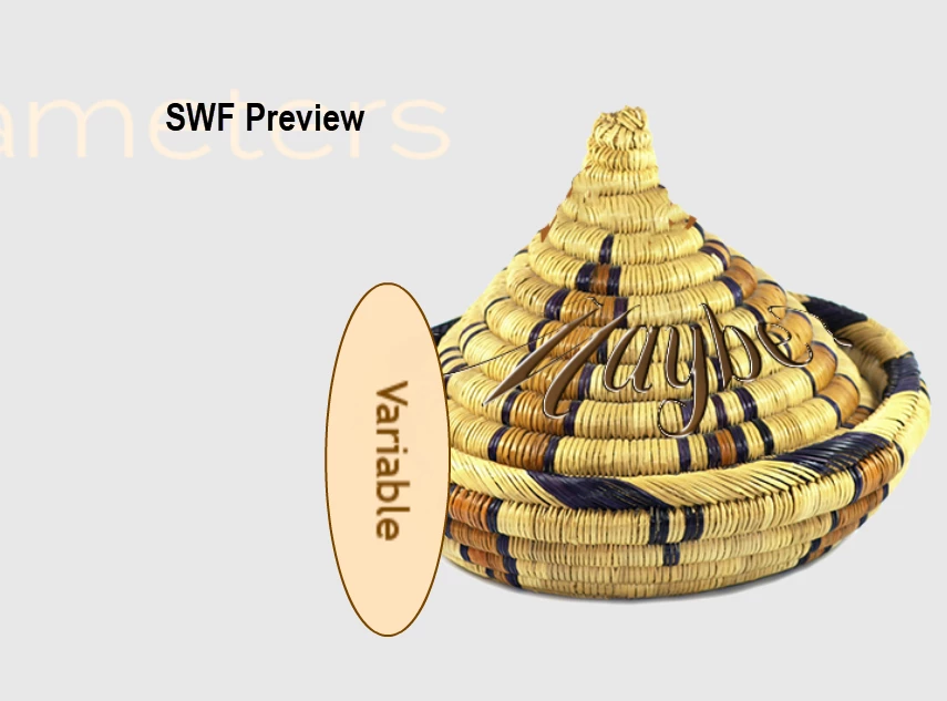

    The behavior when changing to a custom state with the object action, should work IMO and it is doing fine for SWF output. What happens for HTML output is a mystery, and I logged this as a bug.  It looks like unchecking the option Lock in Transformation and Size is not activated for the shape whereas it works for the included invisible text box, which is then squeezed to fit in the not rotated shape. Very weird.

    I tried it out on CP2017 in a normal, non-responsive project. It works fine in SWF output, but not in HTML output but have to confess I didn't publish and upload to a webserver, only  previewed with F11 and F12. I used an ellipse shape, created a custom state that turns it 90°. Shape had text. Works fine in SWF Preview (F12). The result in HTML Preview (F11) is weird: the ellispe is not rotated, but the text is rotated and is squeezed to get into the shape.  If I have time, will publish and upload but have to hurry now.
    You may have bumped onto a limitation, I hope you unchecked the Lock feature, which is automatically set for Drag&Drop assets probably because of the many InBuilt states.
