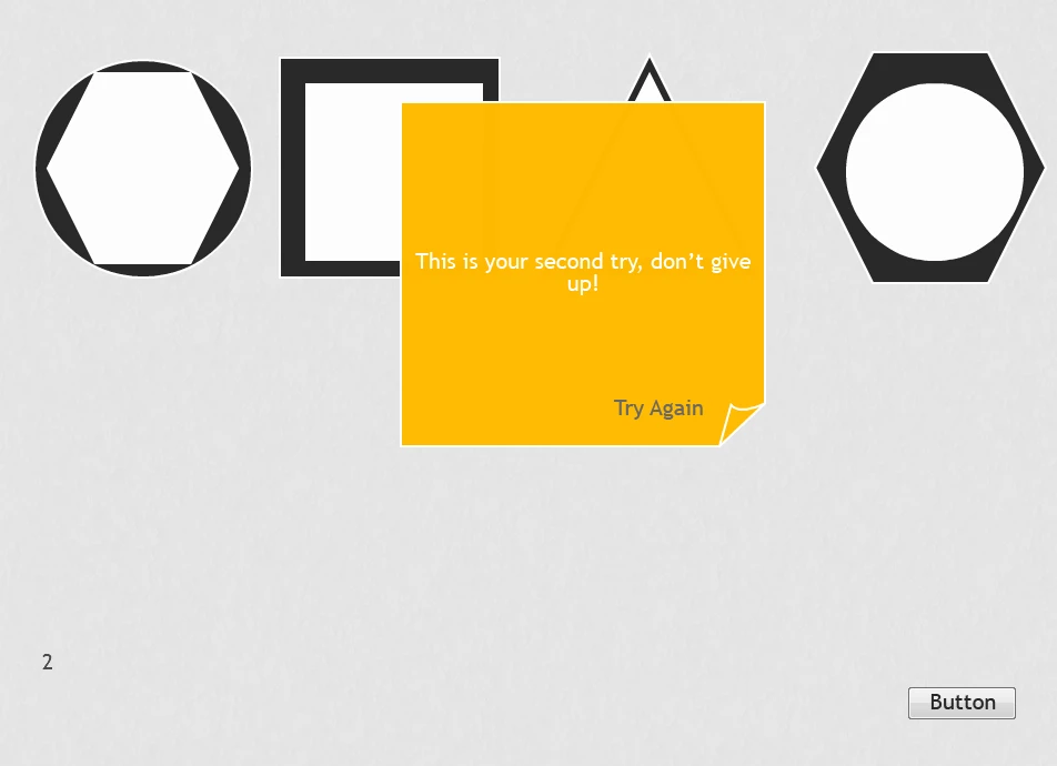

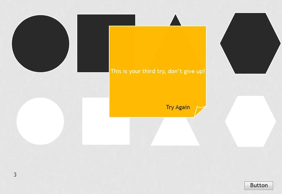

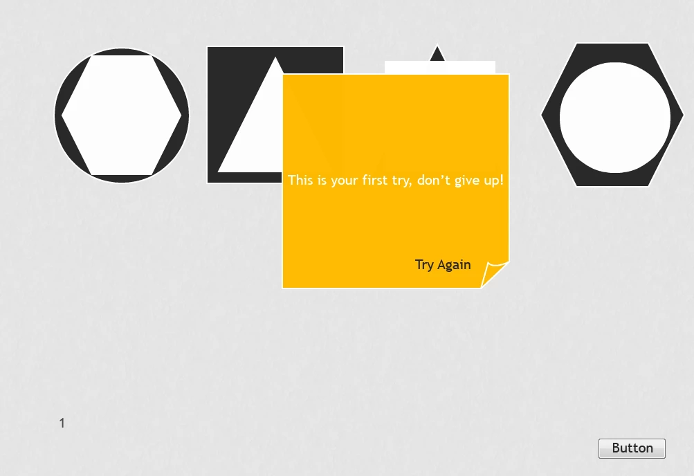

Hi! Yes - this is possible. I created a D&D interaction that verifies if the target is correct, if not, then it displays an error message. Here is the general idea:
  1. Create your D&D interaction
  2. Create a count variable to verify number of attempts.
  3. Create a variable for each correct item, set the value to 0. On correct, assign a command under the drop target > Format > Object actions > Assign var_name with 1.
  4. Create three separate custom messages (I recommend creating 3 Smart Shapes with the custom message and a close button [to hide the custom message] for each, then grouping them together). Make sure that these are not visible at run time!
  5. Create a new button (don't use the D&D default button)to Execute Advanced Action.

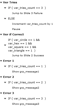

  6. The advanced action should look something like this:
Here is how the project looks:
I hope this help!
