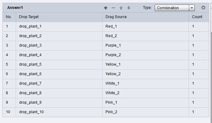

Thank you so much!  I had to shrink the size of my drop targets quite a bit, but it completely solved the random movement issue.  I am still having a little trouble with Captivate recognizing the correct answers though.  As I mentioned, this scenario has multiple possible correct answers.  I have added them all into "set correct answers", but could there be something else I'm missing?  Here is a screenshot of one of the answers:
Apr 18, 2021 3:55 PM UTC
Never mind.  I removed several of the options to simplify the scenario and now it appears to be working.
