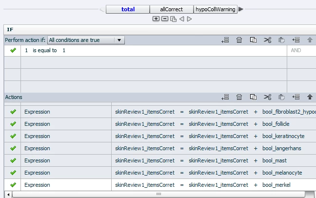

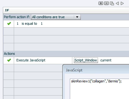

    PS - I didn't post the AA because it's trivial, but here it is anyway.
    The javascript hits a clickbox that then totals everything up, shows warnings, etc. Now it looks like the following:
