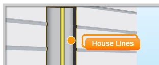

Hi - I created a drag and drop interaction and specified that the drag sources snap to the center of the drop targets. However, they are offset to the lower right when dropped.
Some of my drop targets had shadows around the borders. I removed the shadows, and that worked. However, other drop targets did not have shadows to begin with, and those are still offset lower right.
I tried enlarging the drop target area, but that did not have an effect.
Any ideas? Thanks!!

Could you tell which version you are using, if this is a normal or a responsive project? Please post a screenshot of what you mean by 'offset' and the Snapping properties for that target object in the screenshot? Center for each object means the center of the bounding box, which not always will look like the center of the object if you have strange shapes.

Thanks - I am using Captivate 8 in a normal project. Following are the snap properties and the offset result. The bounding box matches the shape.
