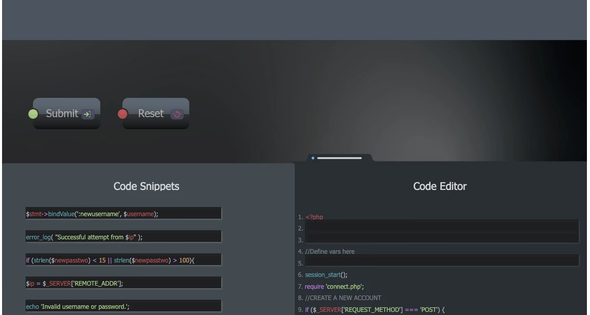

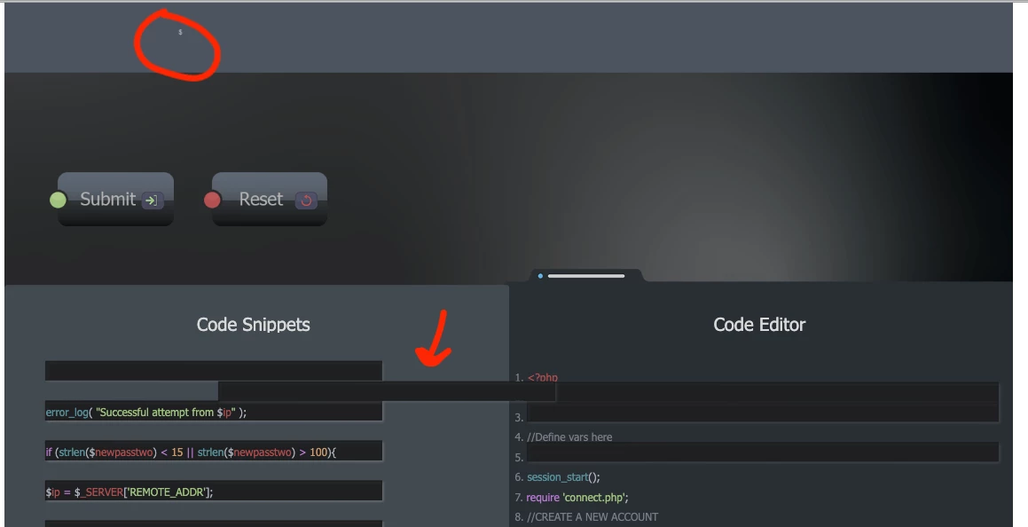

Yes, I mistyped "targets" and meant drag sources. The drag sources are just rectangle smartshapes. I have attached some screenshots, but it is a little tough to see. The first is the a portion of the project while not being interacted with. The second is what happens while dragging a drag source. The circle shows the text up in the top of the project, smaller size and truncated content. The arrow shows what I am actually dragging. The similar rectangle that looks like it has been left behind is there on purpose and isn't a part of this drag issue. The drag sources are initially on top of other drop targets (in case users want to put things back on the left as they work through the question).
