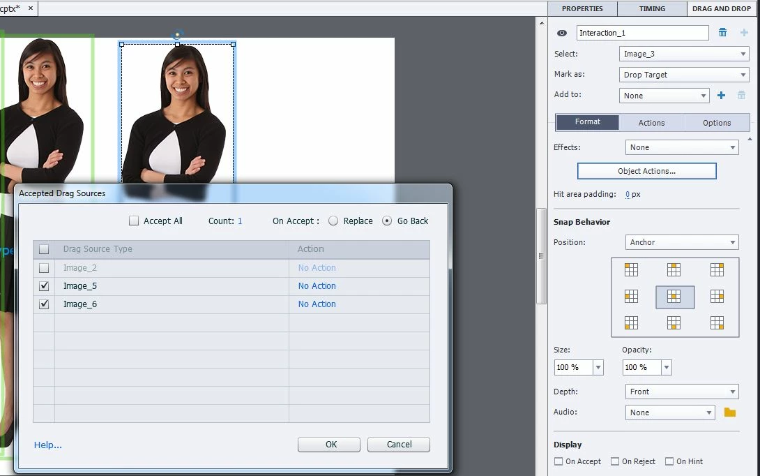

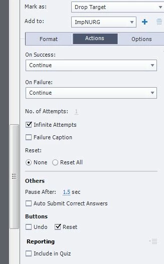

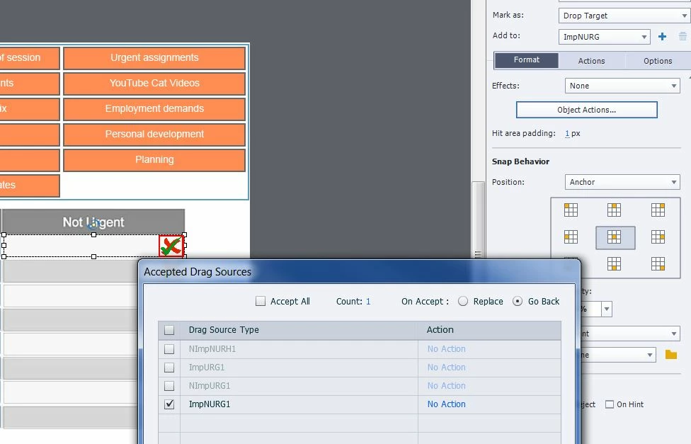

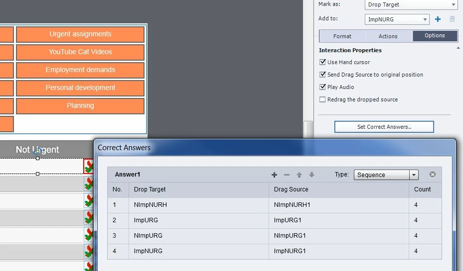

I have table, which is setup up with 4 target group. The drop items are set into matching groups. This is working great except when, for example the drop item ‘Messenger’ which should drop into any of the four bottom right rows. If this is brought to any of the four bottom left rows, you will get the incorrect X but instead of snapping back to the top it snaps to the right into the a correct position.
I’ve tried changing the position from 'Anchor' to 'Absolute' - that did not work
I’ve tried changing the 'Hit are padding' from 0 up to 10 – that did not work
I have 'Send Drag Source to original position' ticked.
Any ideas?
