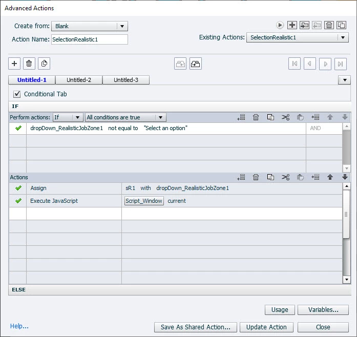

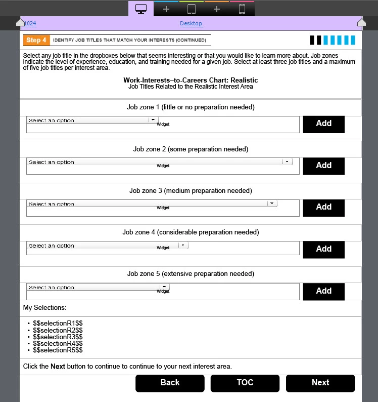

    The slide has 5 dropdowns with many items in each list. Basically, I need to cram in some 500 job titles on the slide and dropdown widget is the only way I figured that it would be possible.
    For the Add button, the action script looks like this:
    And the JavaScript to populate the list of interesting job titles look like this:
