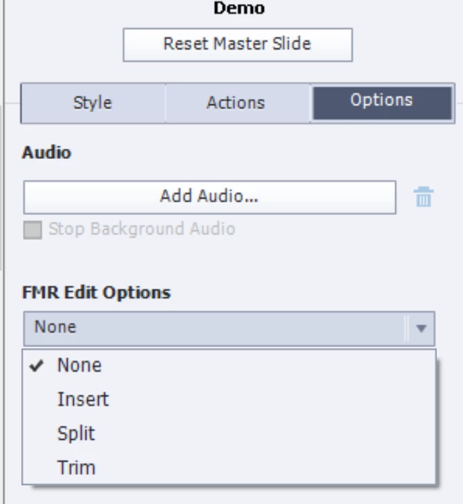

I was wondering is it possible to edit a FMR slide file inside Adobe Captivate or must it be done with an external application?
Would like to take several seconds out of the front of the FMR.

    I avoid using FMR slides, because they sometimes result in issues for HTML5 output, replace them by Video Demo slides.
    To answer your question, yes there are some simple edits which can be done on FMR slides. Trimming is one of them. Go to the Options tab on the slide and you'll find the FMR editing options:

    Hi Lilybiri,
    Thanks - thought I had seen it somewhere. I will look at the Video Demo slides for my next project.
