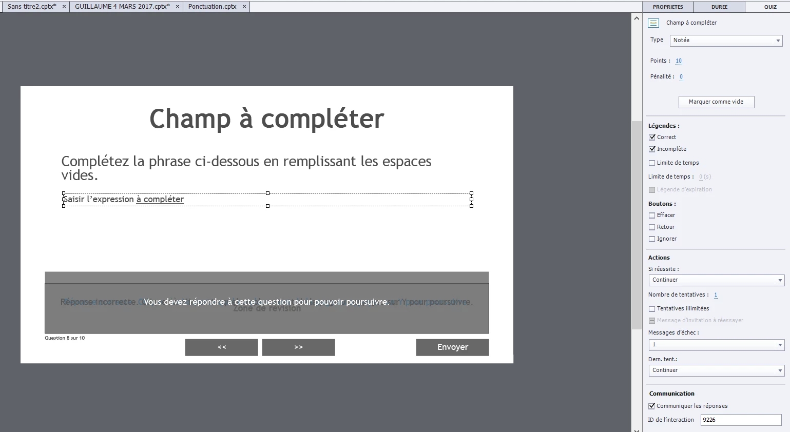

I would like to make a quiz question with empty areas to be filled by the user.
My problem is that I can just write one line of text. I would like to write a whole paragraph with some empty areas in it.
Is it possible?

    That is called a Fill in the Blank question, which is very limited. You cannot have a lot of text in them, they are more meant to fill in one or perhaps a couple of words.

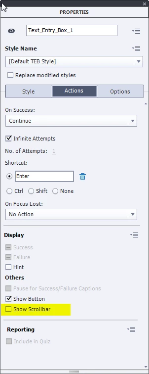

    What are you using at this moment? A Text Entry Box? Did you try to check the option 'Show scrollbar' in the Actions tab of the Properties panel for the TEB?
    Will this be validated? Alternative is to use the Scrolling Text interaction which allows you more control as you can see in this blog post:

    thank you for your answer.
    Here is the type of quiz question I try to use
