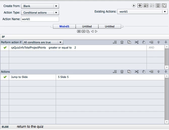

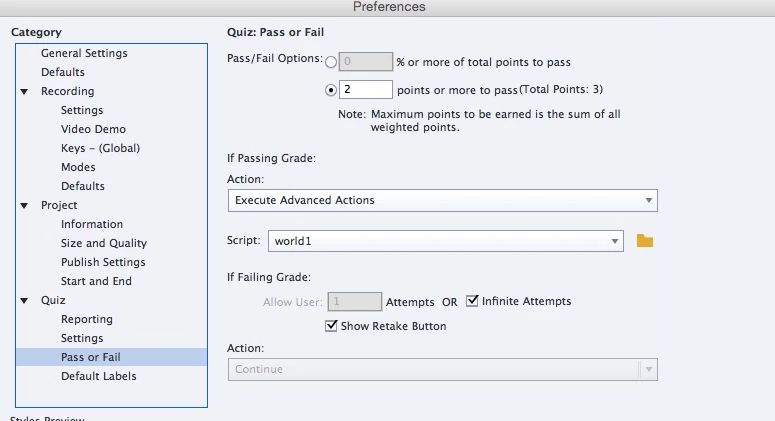

I created a simple quiz and use execute advanced action that if learners pass the quiz, a new slide pops up. If fail, return to the quiz. Below are the screenshot of what I set up. I think I followed the correct instruction but whenever I tried it in the preview mode, it does not work. After the last quiz slide, it keeps moving to the next slide. Thanks!

You choose the wrong system variable. I suppose you want to check the obtained score, not the maximum score?
Use cpQuizInfoPointsscored or cpInfoPercentage. Here is another link, where you can download a descriptive table with all system variables:
System variables in Captivate 8/9 - Captivate blog
