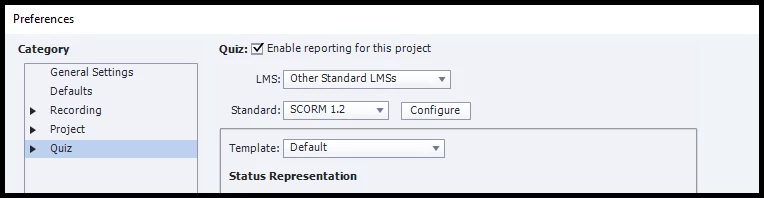

Stagprime2687219
June 10, 2020
To make this a SCORM package you'll need to enable the reporting in your preferences for the project. Then select your settings as appropriate before publishing.
As a side note - you can also modify the files from within the zip folder without republishing.
Your SCORM package will be a zip file so you will need to do that again prior to uploading to the LMS
