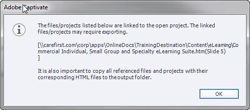

In Captivate 2017, I have a *.htm link on a slide. When publishing, I receive the below message. How may I export the linked *.htm link/file so the link will work in the published project? Thank you.

    Are you publishing to SWF?

    Yes, publishing SWF, PDF and HTML files.

    Oops.... with end of Flash Player happebing very soon! I haven't published to SWF since about 3 years.
    It used to work, if my memory is correct. I think the link to project was used. You need to publish all the projects, and when uploading you have to be sure that the links are relative, and that the ssame structure/hierarchy is kept between the published swf's as was the case for the projects. Upload everything with that structure. Not sure however if it still workfs, almost no one is publishing to SWF anymore.
    This will not workf for HTML5 output.
