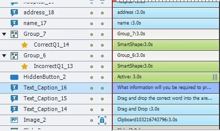

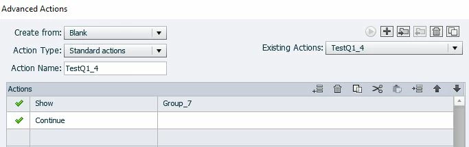

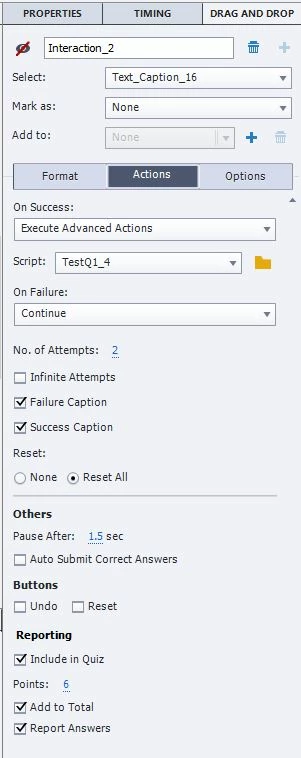

I added buttons to the success and failure captions as they were not actually doing anything when you clicked on them. I then grouped them and added a standard action to the success caption.
In my question f I get the answers right on my first attempt, all works perfectly. If I get my answers wrong (just press submit) and have my second attempt, the correct messages just flashes up. I added buttons to the success and failure captions as they were not actually doing anything when you click on them. Technically in this case the learner can't get it wrong as the answers have been set up to bounce back if not correct. I know this means I could actually get rid of the incorrect message altogether have them carry on however I would like to know why the standard action isn't working.

Hope you don't mind my 2cents... Since the last version (9 at this moment) I also did have a lot of issues when trying to publish to both SWF and HTML5. It can be due to the many differences between both outputs: result of effects, of learning interactions, even advanced actions do not act the same way. I'm not talking about features unsupported in HTML5, but more significant differences. For that reason I will never publish to both anymore. The client has to decide for one output, or I will publish to both but separately. It takes the double amount of testing as well. Motion paths combined with other effects mostly will not work as expected in SWF output, many learning interactions do not work as expected in HMTL5 output (even after uploading to a webserver, timing interactions are good example),, micro-navigation is less to be trusted for HTML5 output....
