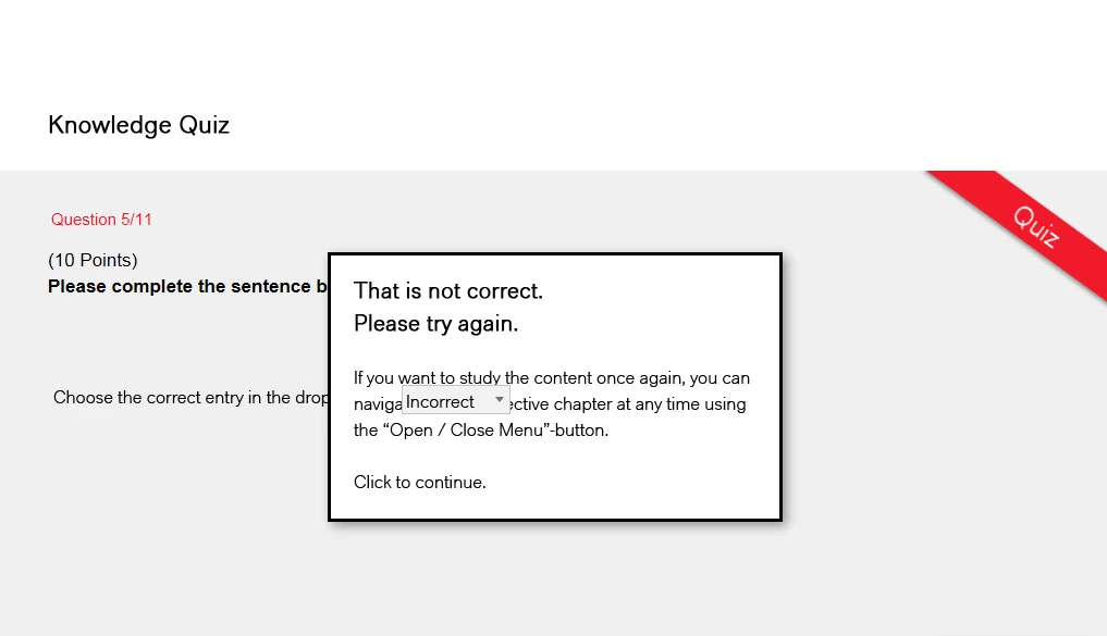

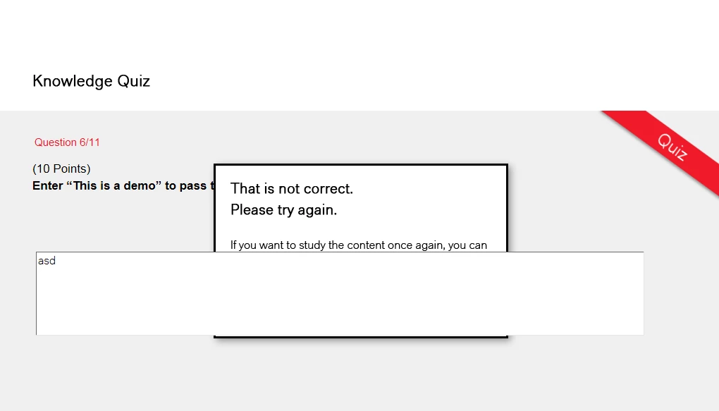

I created a quiz with Captivate 9. When publishing the quiz to HTML5, the failure messages (and correct / retry messages as well) are not displayed correctly. They seem to be arranged "behind" e.g. dropdown boxes. Sometimes the look gets quite weird. In case of large text entry boxes, the messages sometimes are not even readeable because the are displayed behind the text entry box.
I could not find out how the set the failure captures in the foreground. Can you help me with this?
I attached a screenshot, so you get an impression of the problem.
Thank you very much for your help!

Are those the default messages? It looks like you deleted quite a lot of embedded objects on those question slides, which may explain why you are having strange behavior. Embedded objects are those objects (with lot of inbuilt functionality) that do not have an individual timeline, not on the quiz slide nor on the quizzing master slide.

Unfortunately, the problem still exists. I tried to use completely "standard" question slides in a new Captivate project. I tested it with one of the build in themes. But when exporting to HTML5 dropdown boxes or text entry boxes are always in the front and overlap the build in failure /retry / correct messages.
I also tried to turn the messages off and on again. But unfortunately, that had not the desired effect and did not solve the problem. I even tried to activate the messages as the very last object on the Quiz slides, so that they should be in the front. But they appeared in HTML5 behind the text boxes again.
The problem only occurs when exporting to HTML5. In the preview window or in Flash export, the messages are displayed on top.
Do you have any other ideas?
