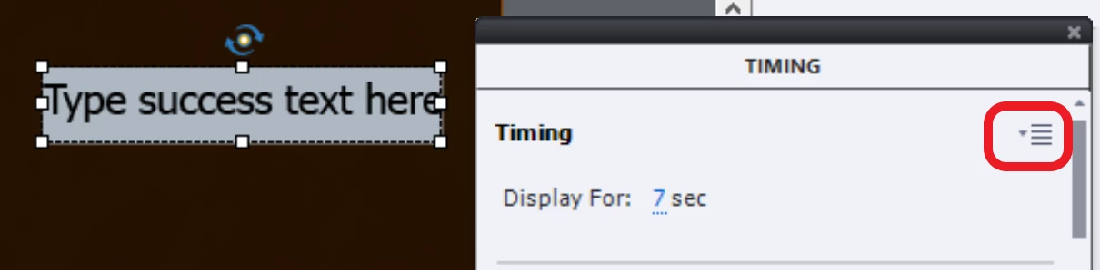

    Aug 3, 2020 5:14 PM UTC
    Your question was indeed very confusing, since you were not at all talking about 'quiz questions'.
    For simple feedback messages:
    • select the feedback message
    • open the Timing Properties panel
    • change the duration to what you want; default duration is 3 seconds:
    In the screenshot I highlighted the hamburger menu.  You can use it to apply the new duration to all the items with the same style.
    Be careful: most included themes and the QSPs have a bug where all feedback messages use the Success style, instead of the correct style for Failure and other messages. Same bug as was also in the first release of CP2017 is still there in 11.5.
