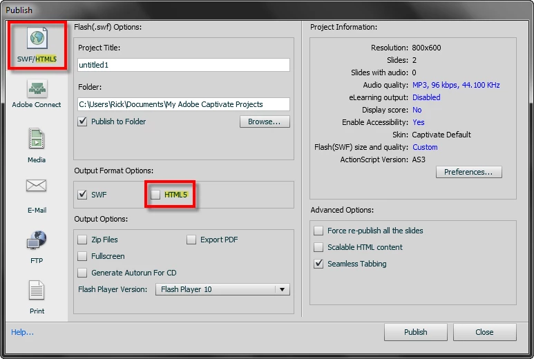

    I just looked at the output option in Captivate 7 and don't show HTML5 as an option.(Or at least I can't see it.)
    Will that solve the issue because I can't loose the interactivity.
    Also, the next question then is does Muse support the HTML5 output where I used to have the Flash HTML code or is it just a replacemennt of the code?
    Captiv8r
    Mar 23, 2014 8:10 PM UTC
    Hi there
    So when you click File > Publish from Captivate, you don't see this dialog:
    Cheers... Rick
