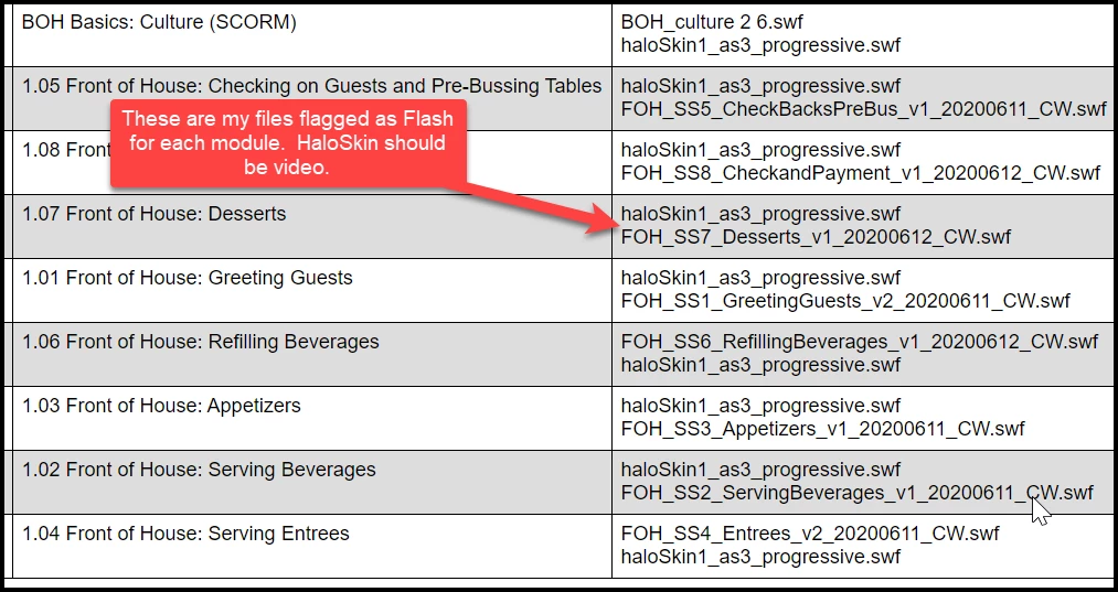

Flash report from my LMS administrator
Hi, all.
My LMS admin sent me a report for Flash files within modules.  In every module, it flags "haloSkin1_as3_progressive.swf" as a Flash file.  I think this is my embedded video.  I published as HTML5 and it works...now.  But I need to know if this will cause issues after Flash dies at end of year.  I get my videos from the company videographer (who uses Adobe to edit and render.)  Is there something he needs to do differently to give me videos that aren't .swf?
Sorry - I'm not very good with the technical lingo or the "back end" of Captivate.  Thanks for any advice you can give.

    Probably the playbar. No worries, normally when published to HTML5 will be fine (they have some magic around also for interactions to have compatibility with HTML5). Sorry, didn't try to explain the magic, but I am confident.
