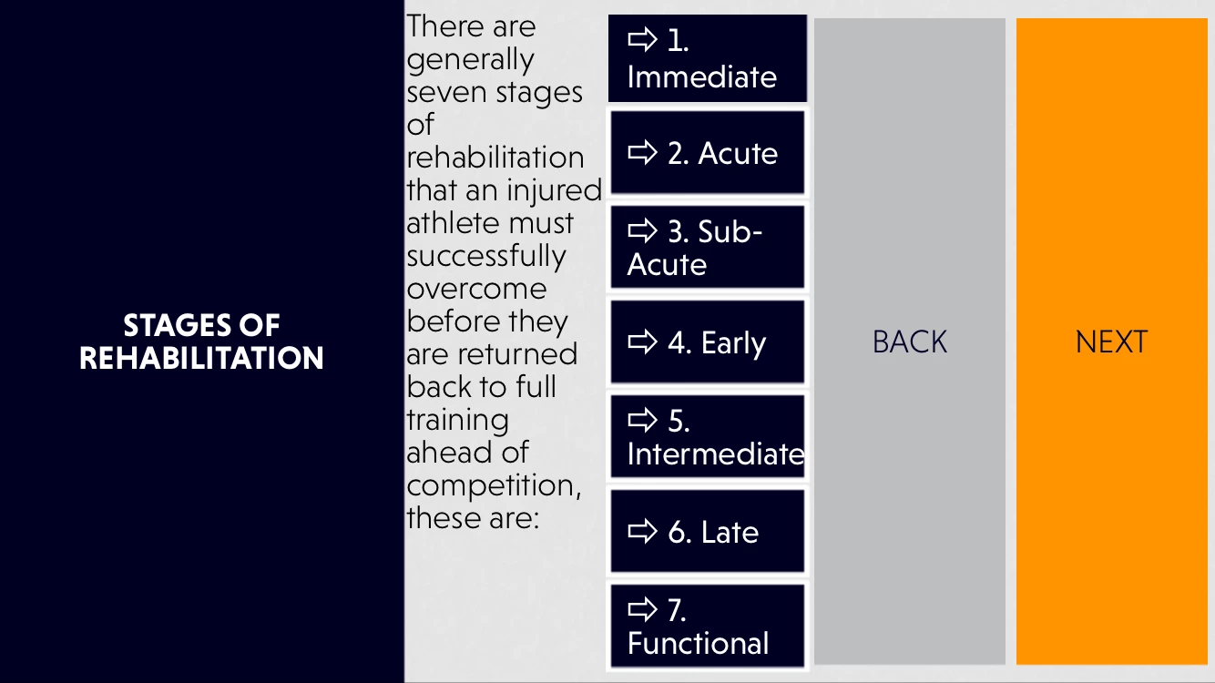

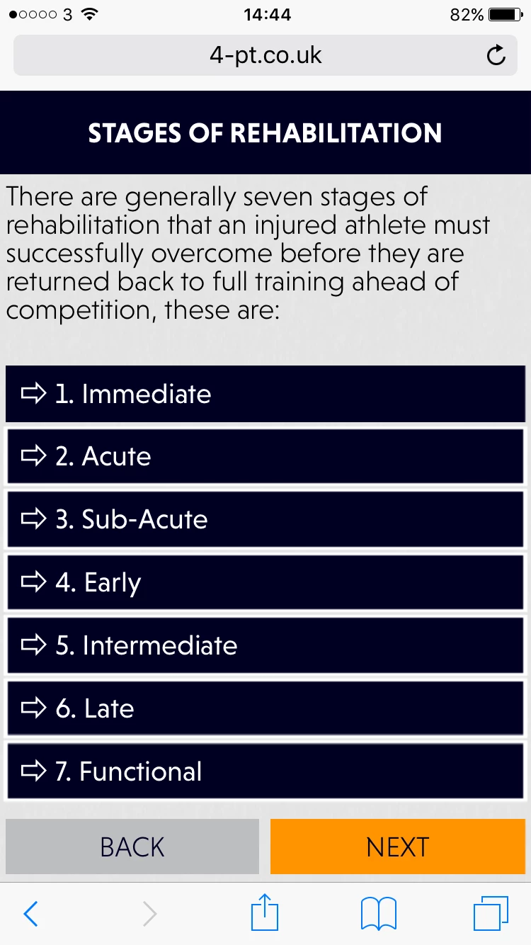

I'm exploring fluid boxes and have a question. My content looks like this on an iPhone 6 in portrait orientation:
However, when I rotate my device to landscape the content looks like this:
Can anyone help me understand why this is happening please?
It seems as though the layout starts to break down when the device/browser height is 520px or less.
Thanks in advance.

dt4ptAuthor
May 3, 2017
Hi Lilybiri,
The FBs are on the actual slide. I have uploaded the slide in question here if it helps: http://www.4-pt.co.uk/samples/captivate/slide-2.zip
Thanks for helping.

dt4ptAuthor
May 4, 2017
Thanks Lilybiri, the changes you've made have solved the issue.
I will now attempt to apply the changes across the board in my demo.
Thank you for your help, as always it's very much appreciated.
