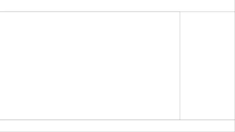

I'm going to try and explain my problem, see referenced images for clarification.
I have my desktop viewport so that I have 3 horizontal fluid boxes; a smaller box on top for title, a much larger box in the middle for content, and then another smaller box on the bottom for navigation buttons. My middle fluid box is then split vertically into two boxes, the left side taking up roughly two-thirds and the right take up the remaining one third.
My problem is that when it collapses into a smaller viewport, the 2 middle fluid boxes become the same size; they do not retain the 2/3 to 1/3 ratio and I can't figure out how to resize them after the collapse.

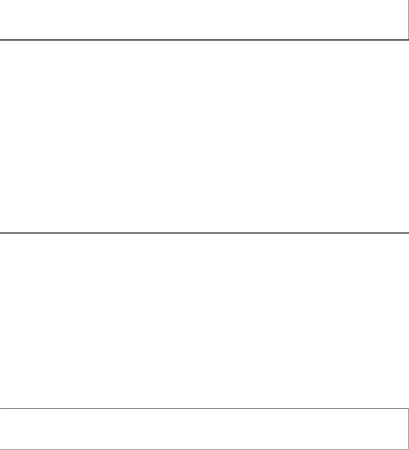

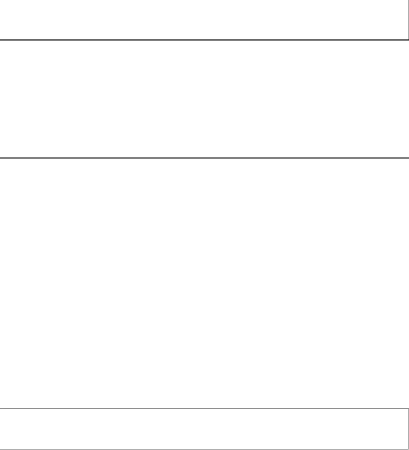

    I threw together some real life mockups of what I'm trying to do.
    Hope it helps!
    Desktop_view is what the project starts with. I would like for the mobile view to be like the "What_I_Want" image, however, what I get is the image "What_I_Get".
    I don't think that this is possible with Fluid Boxes. Since the 'father' fluid box is defining the height, wrapping the child fluid boxes will result in them having that same height.
