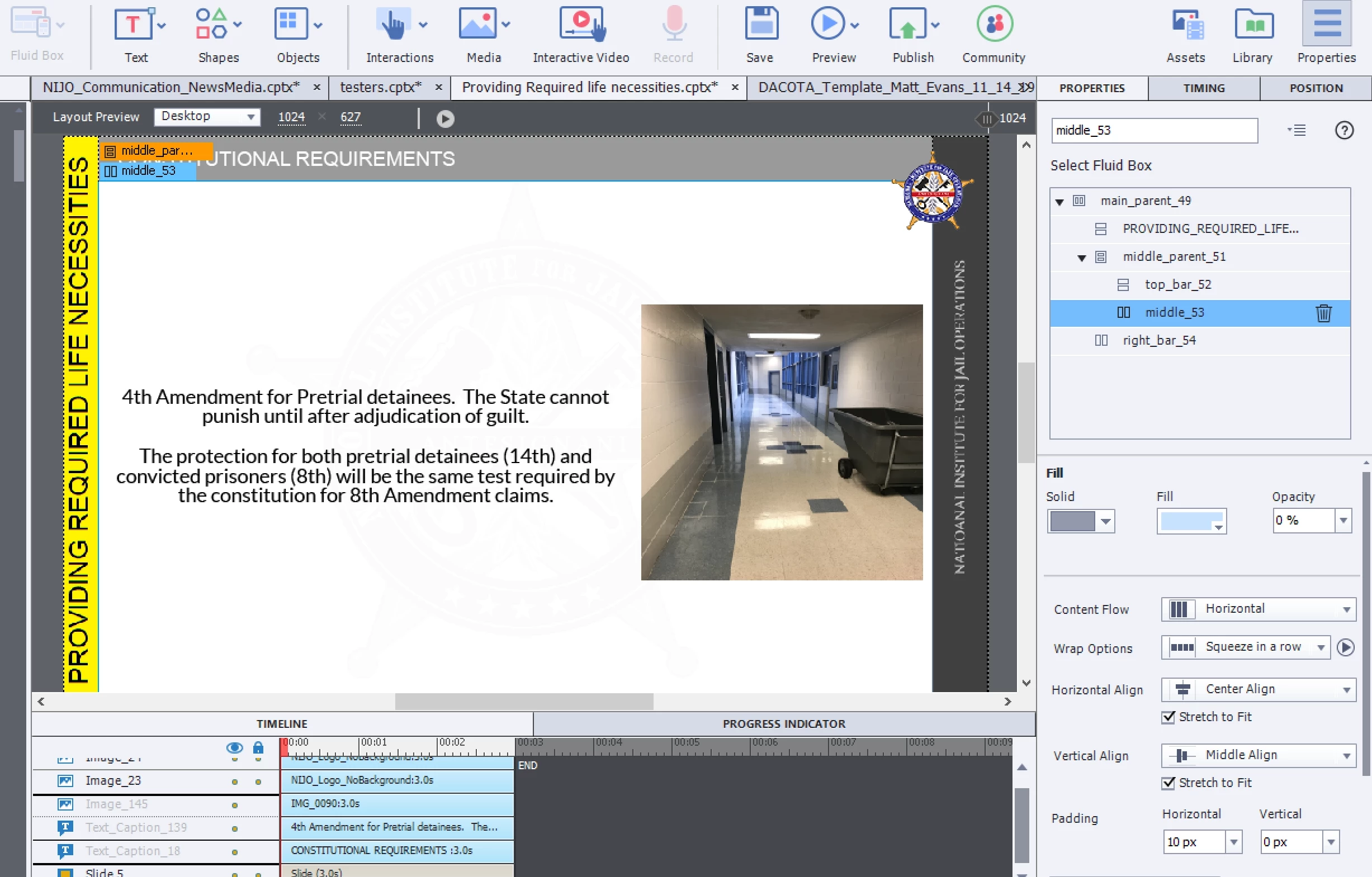

I have been trying to figure out this responsive project with the fluid boxes. The last project I did was not responsive so the fluid boxes have been new to me. The one thing I can’t figure out of how to put in Vertical buttons but have the content be horizontal.
Part of the problem seems to be fluid boxes being grayed out when I try to add more with the template they gave me. Here is what I see when trying to add more fluid boxes to the middle box.

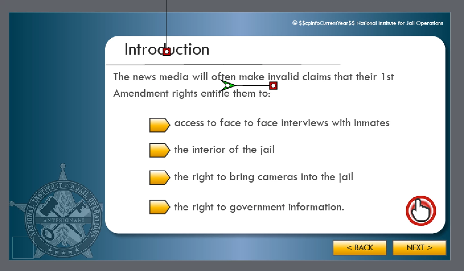

I would like to add buttons like this one for the text to appear like from a previous project:

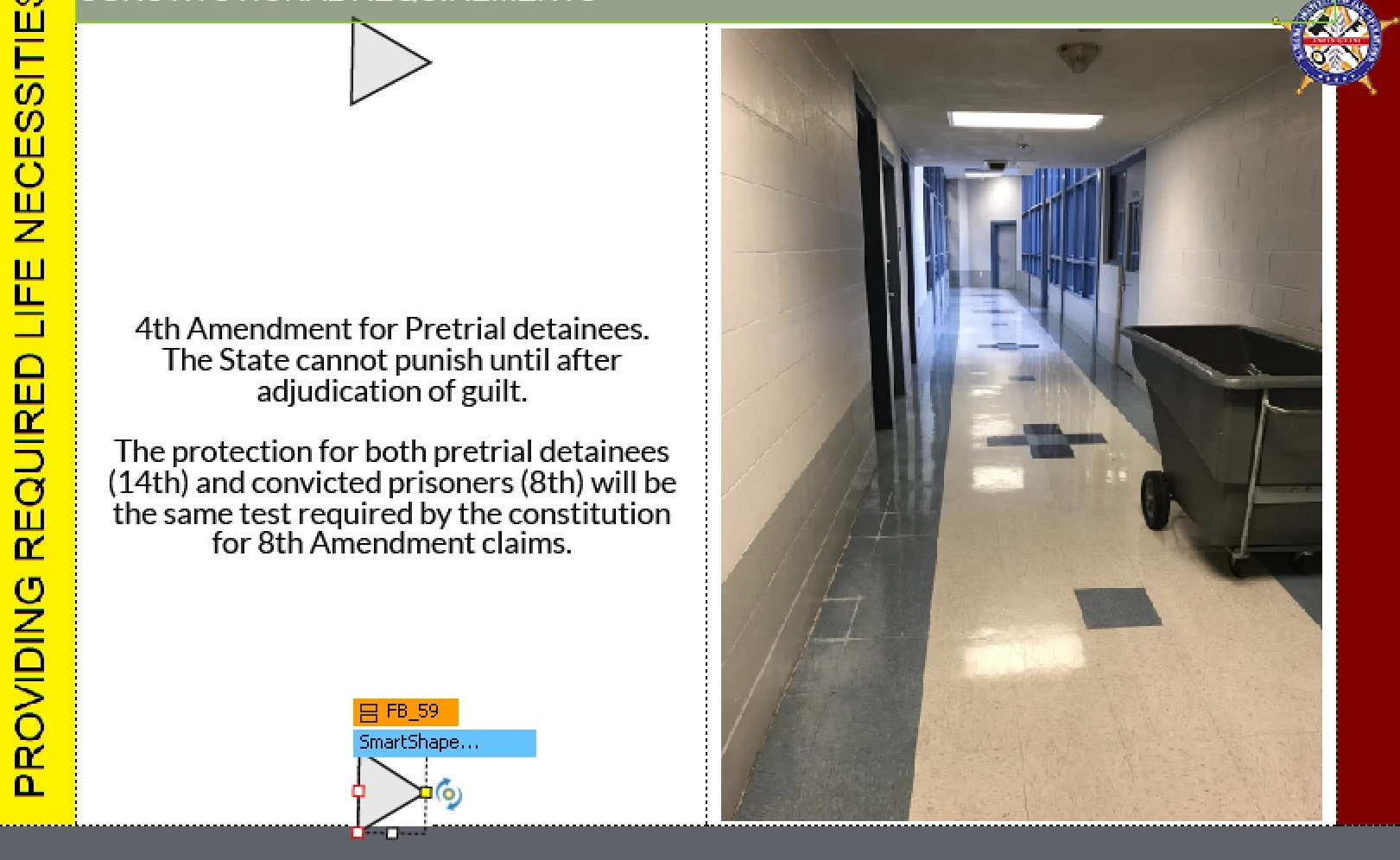

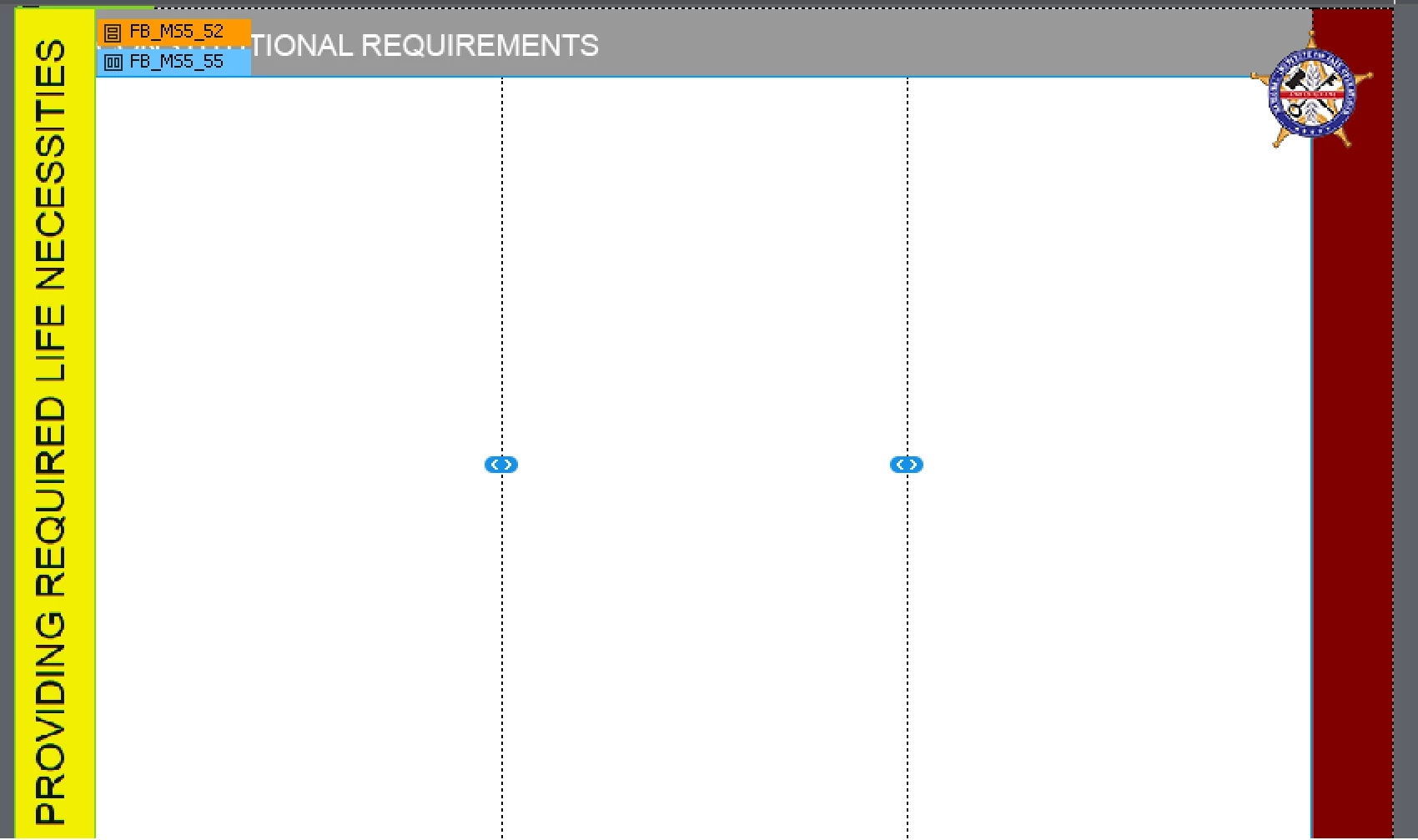

Anyways, I experimented with having the template as a master slide and It seems to work better:
Even with that, I still can't seem to make it work because I need the shapes horzontal to the text but vertical to each other. Do I need a third fluid box for the smart shape buttons???

Are you talking about a template, which is a cptl file, or a project using a specific theme?
Which version do you use, as mentioned under Help, About Captivate?
Fluid boxes button is grayed out when a fluid box has content. You can only add fluid boxes to an empty fluid box.
kimberlyu44812036
Dec 5, 2019 1:34 AM UTC
Thank you!!
It is just a specific theme, a cptx file, not a template file. I am using captivate the 2019 version.
Thank you for the content help.
I didn't realize adding content did that! So simple!
Any advice on lining up the buttons? I'm thinking I need to use 3 fluid boxes...
Lilybiri
Dec 5, 2019 9:12 AM UTC
I think the problem is that you didn't have any training on fluid boxes, which are a lot less easy than the marketing people claim. In one of the screenshots which has a timeline, I see that some objects are not IN a fluid box at all, are you aware of that?
There are many ways to align the buttons, in one fluid box or in multiple fluid boxes.
