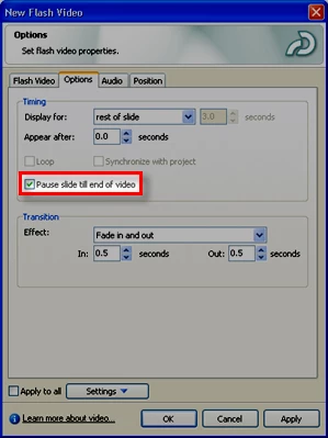

    Aug 5, 2009 12:02 PM UTC
    Hi Steve
    Unfortunately the "Pause slide till end of video" option has been there since Captivate version 2. I just fired it up to double-check.
    Here is a screen capture:
    Click the image if it's small to view at full size.
    If the option doesn't seem to be working, please consider submitting as a bug. (Link is in my sig)
    Cheers... Rick

    Aug 6, 2009 1:19 AM UTC
    Thanks for your reply Rick, maybe I'm not understand the function then, with the Pause Slide until end of movie selected should the slide advance when the move is finished playing?
    It works if you select specific time and enter the duration of the movie but with Captivate 3 even with the specific time entered the slide would sometimes advance before the movie ended or sometimes it would finish and pause a few seconds before advancing to the next slide.  Which is one of the reasons I upgraded to Captivate 4 for my current project.
    As I said the problem I'm having with Pause Slide until end of movie is when the movie is finished the slide freezes and will not advance until you select the play button and then the next slide starts.
    Thanks again,
    Steve Cocklin
