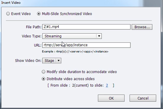

Your welcome, if that is the case, then can you try and insert the MultiSlide Video, you can insert the streaming video URL.
You can add the server to you computer as network Drive and then browser to that location, once you do that, the options to add the Video as Streaming can be chose and your Vidoe would remain insync with main playbar, users can play and pause content that way.
See if this can be implemented at your end.
