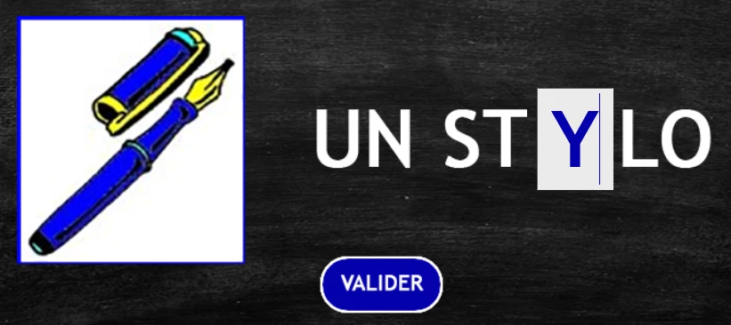

I'm trying to put the focus on a TEB (Text_Entry_Box_1) when entering a slide... so that the learner don't have to click on the TEB to activate it...
So far I try many javascript code without success :
Solution 1 :
window.document.getElementById('Text_Entry_Box_1').focus();
Solution 2 :
$('Text_Entry_Box_1').focus();
Solution 3 :
$('#Text_Entry_Box_1').focus();
So... Some help would be appreciated !...
Thanks in advance !...

    Dirlo
    DirloAuthor
    May 22, 2023 4:06 PM UTC
    Project updated !...
    As I had only 1 action to enter all the question slides, I fear I would have to create a new one for each slide... But I just add 1 action to my existing action :
    setTimeout(function(){
    $("#Text_Entry_Box_1_inputField").focus();
    $("#Text_Entry_Box_2_inputField").focus();
    $("#Text_Entry_Box_3_inputField").focus();
    $("#Text_Entry_Box_50_inputField").focus();
    $("#Text_Entry_Box_51_inputField").focus();
    $("#Text_Entry_Box_52_inputField").focus();
    }, 200);
    And it's ok !...
    Big thanks to all the helpers on this forum !... Without all of you, no doubt  I would have stopped using Captivate for long !!!...

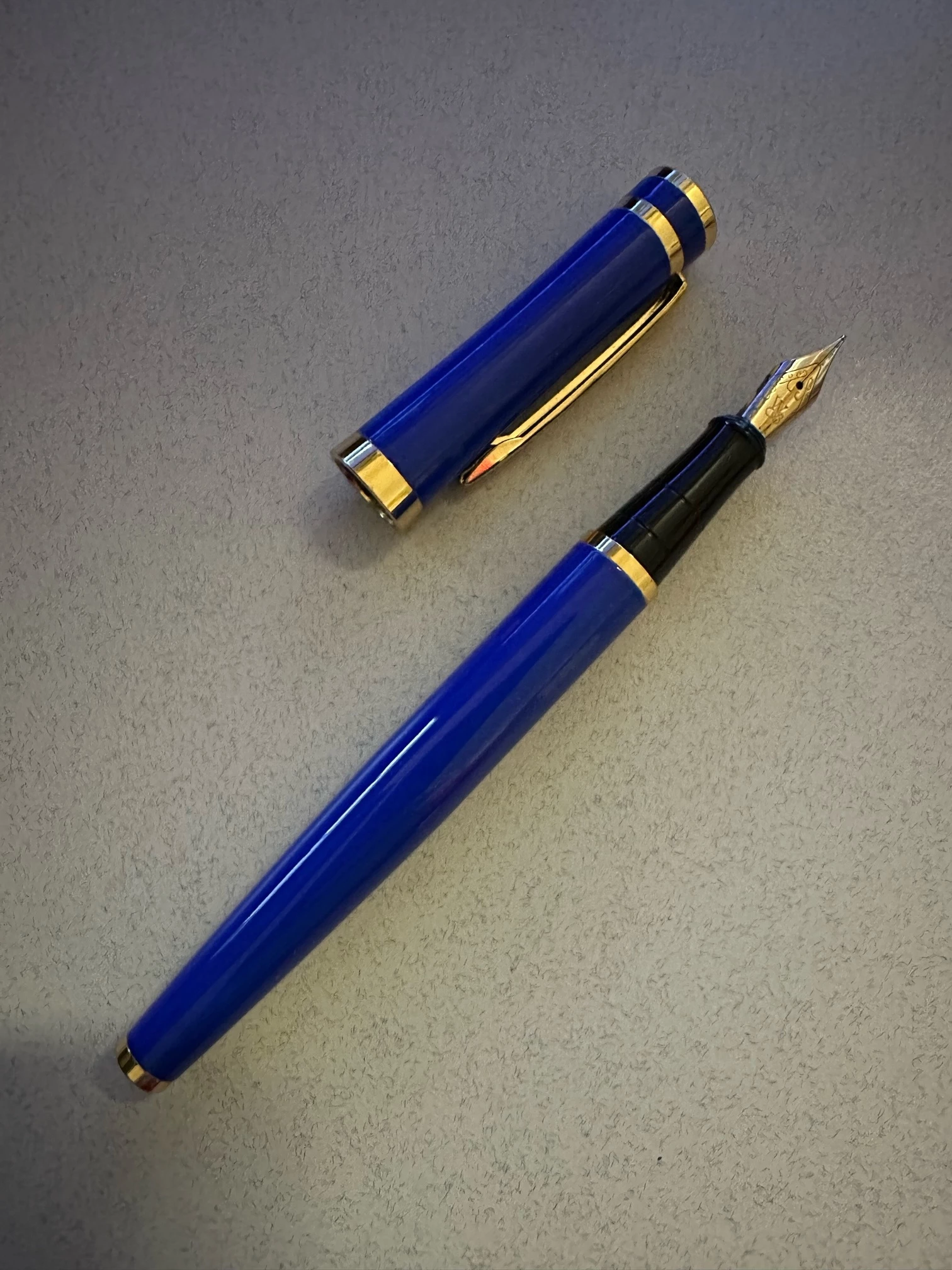

    Stagprime2687219
    May 22, 2023 3:37 PM UTC
    I have the same pen... LOL
