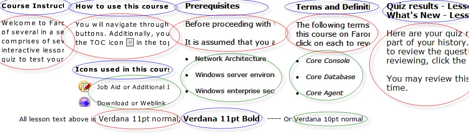

I am continuing to experience problems with fonts in my projects.
As a standard, I am only using Verdana 11 pt and 10 pt in my slides. This standard/consistancy is quite evident when I am viewing the slides in edit view. However, when I preview or publish the project, the text from slide to slide is not consistant.
It appears as through some slides display Vendana slightly squished... it is clearly Vendana just reduced in height. I have tried various options, such as setting the quality mode and so far,nothing has helped.
Please see the attachment, which should better illustrate what I am describing. Each of the five 100% cropped screen captures are from separate slides and I have combined them into one jpg.
Any ideas?

Hello Rick,
This may all be true but if you see my earlier posting where I attached an example, this is not simply a anti-aliasing issue (I did try turning this on/off with no change in this respect). The actual font is a different size (like the font was shrunk - vertically).
Also, as I explained, I found that it is specifically related to which text caption is used, namely the transparent one. This is just really weird and I wonder if it is repeatable on other computers (besides my two).

November 28, 2009
Greetings Rick, thanks for your reply!
I should clarify that all the text is within the main project and placed within an ordinary "Text Caption"
Additionally, I have removed the text and ensured that there are no high-bit ascii characters and re-pasted into the Text Caption. I have also created a new Text Caption with clean text. It still looks the same!
More twists:
- If I copy a 'good' text caption to a slide where there is a 'bad' text capture. The 'good' text caption renders correctly in preview.
- If I copy the 'bad' text caption to a slide where there is 'good' text, the 'bad' text still renders incorrectly. This makes it appear that the problem is specific to the Text Caption.
- If I paste/merge the 'bad' text caption text into a 'good' text caption, the 'bad' text caption renders correctly. However, if I delete all the original 'good' text, the other text suddenly renders 'bad' again. It is as if there is something 'bad' in the text. I have even copy/pasted from Notepad (b/c it strips all junk from text).
- Finally, I opened a text caption on a slide with 'bad' text AND on a slide with 'good' text. In both cases, the brand new text caption with the simple words "Test" in bold...line... "Test" in normal Verdana 11... rendered in preview as bad (bold cases).
I tried a number of other tests and came to the conclusion that .... oh I don't know! This is nuts!
Seriously, it seems that text captions no longer render correctly. I guess that is my conclusion. Yes, I did try other fonts with the same result. Yes, I tested this on multiple computers and multiple browsers.
I hope this makes sense.
