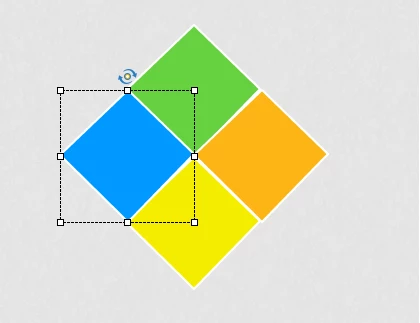

    Sorry, didn't explain it as thoroughly as I should have. I am on Captivate 9.0.2.437. I am using free form smart shapes with the inbuilt rollover state. I have made an example and will post a series of pictures to show my problem. I did them quickly in Paint and since printscreen doesn't show where the cursor is, the black outline arrow is where the cursor would be.
    This is made of 4 separate diamonds using the polygon smart shape. Each diamond has an inbuilt rollover state which changes its color to red. The diamonds on the left and right are at a higher level than the diamonds at the top and bottom. As you can see, the dotted bounding box covers a section of the other objects:

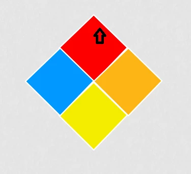

    On publish and preview in HTML5, rolling over the side diamonds turns them red as expected for the entirety of the shape:

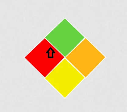

    However once you rollover to the top and bottom diamonds which are on the lower layers it does not trigger the rollover state:

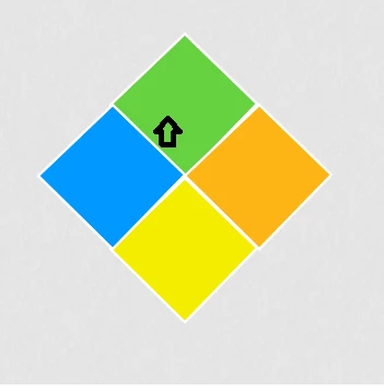

    That is until you get past where the dotted bounding box was when you made the shape:
    This occurs on both ends and if you change the layers around so the top and bottom shapes are at the top and the right and left shapes are at the bottom only that now the right and left shapes do not get interacted with until they get past the bounding box.

    I don't see answers to the question: is this a button? Only shape buttons and Drag&Drop objects have inbuilt states. Although you can define a rollover state for each shape, they'll only be active when the shape is activated as button.
    You cannot have overlaps however, and overlapping means for the bounding boxes, not for the shape itself. That is what is causing the problems. However I don't understand why you didn't use rectangle shapes that were rotated 45°? That way you could have avoided any overlap.
    Of course, that will not help for irregular shapes. You will have to layer 'invisible' shapes in such a way that you don't have overlaps in that case. Beware: Rollovers are not supported on responsive projects and not guaranteed to work in pure HTML5 output. Is it a good idea to still use rollovers? Moreover if you upgrade to CP2017 and want to use Fluid boxes, it is not even allowed to have overlapping objects unless using static (more limited) Fluid boxes.
