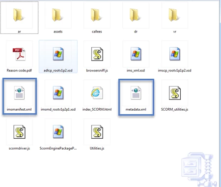

    I figured out what went wrong and it was my mistake. The original setting was unchecked that was causing the error message to occur:-
    After checking it and republishing it just in HTML5, the xml files are appearing:-

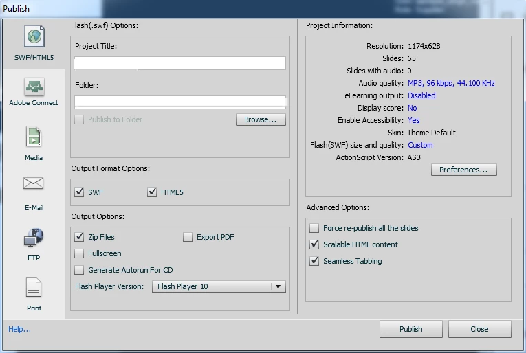

    Below is the settings that I had used when publishing the file
