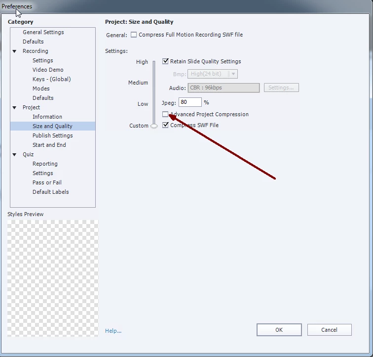

Please uncheck the Advance Project compression option from the Edit>Preference. It might help you to remove that ghost line.
Rajeev.
March 20, 2015
Thanks for the suggestion. Unfortunately, publishing with the Advance Project Compression checkbox unchecked gives the same results as publishing with the checkbox checked. The ghost lines are still there. I have found that moving the highlight box a pixel or two up or down will eliminate the lines.
