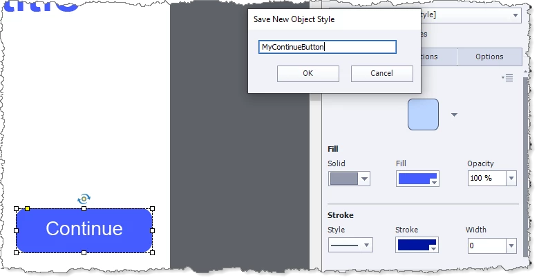

    Onc you have one of your buttons set up properly you can apply this fix to all of your continue buttons by saving these settings as a custom Object Style (e.g. MyContinueButton).  Then you apply that same style to all of your Continue buttons.

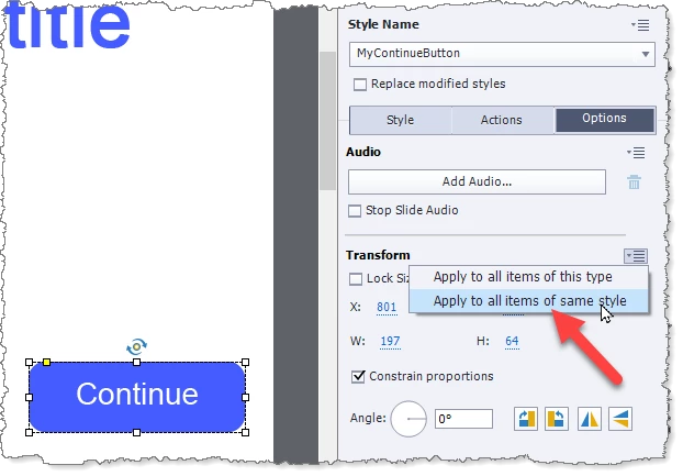

    That will make them all use the same font and font size, but to get them to all be the same height and width and location on the stage you then need to select your ideal button and find the option under Properties tab > Options > Transform to Apply to all items of the same style.
