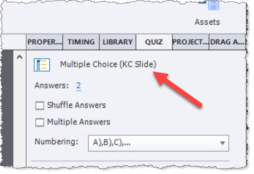

    RodWard
    Oct 1, 2021 1:55 PM UTC
    Are you sure these are quiz question slides and not Knowledge Check slides?
    Select one of these slides an look in the top of the Properties panel.  If it is a Knowledge Check slide it will show KC after the type of slide.
