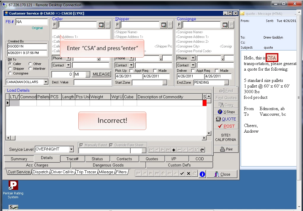

Hello, I'm in the processs of creating a software assesment for our program in captivate 5. I completed the demo portion without any glitches however when I play back the assessment now, the glitches slowly stack up the further I go. I've tried clearing the background and re-adding it from the library. and it worked a few times however some slides are resilient. here are some pics:
this is what my screen looks like in captivate before I actually publish it or preview it without any glitches:

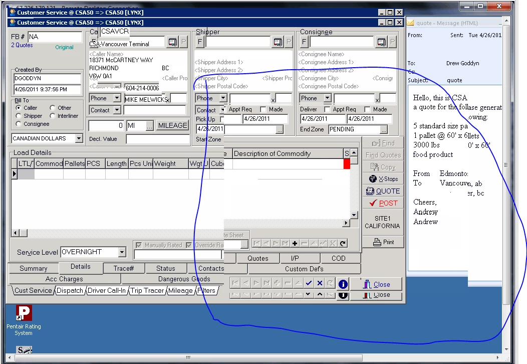

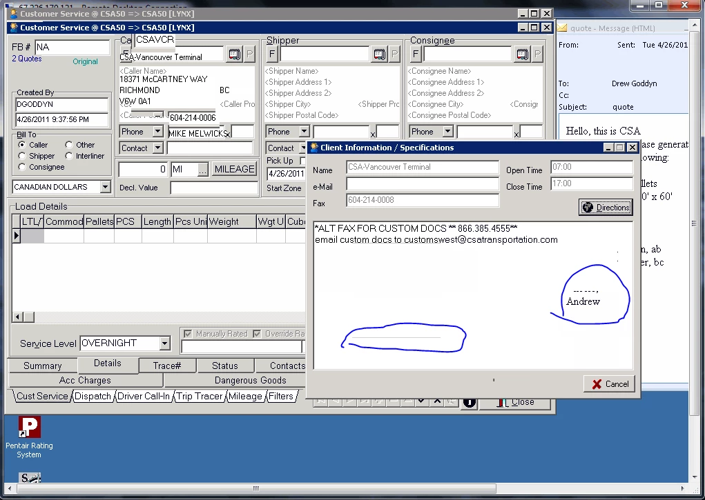

Notice how there is no glitch until I actually preview the video. If I start exactly on the slide where the glitch usually appears, everything is fine, it seems to be an issue that builds up the more slides that go by. I've also tried increasing the screenshot image to higher quality.
