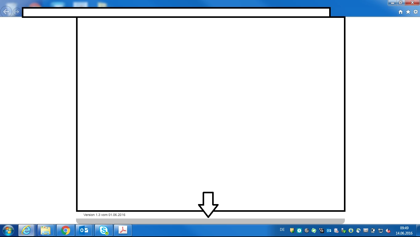

Hey guys,
I've tried to publish a presentation in HTML5, everything has worked out well - except there's a grey bar at the bottom of the presentation, as you can see in the picture I attached. Does anyone know how to get rid of it?
Thank you!
    Correct answer Lilybiri
    You took out the playbar, but forgot to uncheck the borders (also under Project, Skin editor); that grey bar is the placeholder for the playbar.

    You're welcome. It would be great if this happened automatically when unchecking the Playbar,  but that is still not the case.
