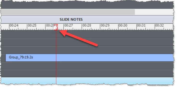

    As Lieve indicates, if you are more familiar with other video editing apps, the way Captivate's time works in its editing environment may be different to what you are accustomed.
    In Adobe Animate or Premier you only see items that would be visible at runtime when you place the cursor on a specific frame. But with Captivate, all objects on the slide are visible in Edit mode, unless you hide them using the controls on their layer.
    However, if you just want to temporarily see which specific objects would be visible on the timeline at a given frame position, there is a trick you can use.  Just click on the frame position of the timeline so that the red line that indicates the editing cursor moves to that position.  Then move your mouse cursor over the square at the top of that line until it changes into a hand cursor.  Press down on the mouse and you will then see any objects that would not be visible at that point disappear until you release the mouse.
    This gives you a quick way to see how things would look at runtime.
